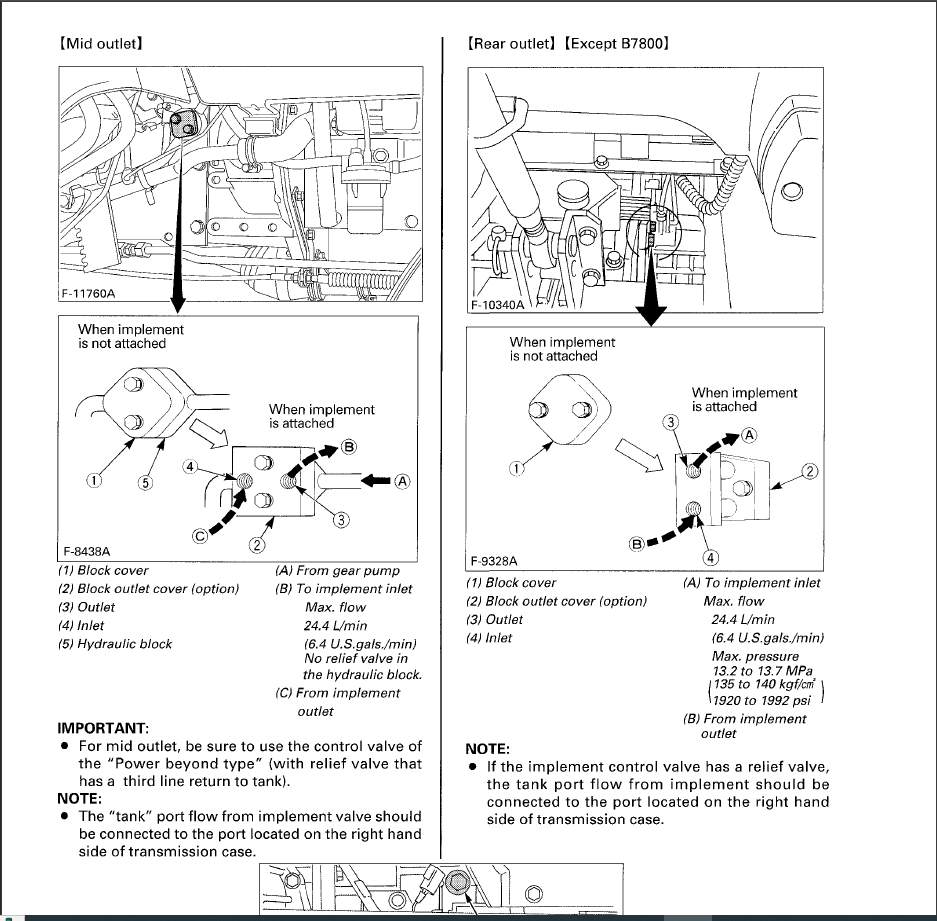

T Tuskar Member Equipment B2710 . Flail mower .finishing mower cement mixer . Transport Box Log splitter. Jan 11, 2023 35 4 8 Weissfjord , Ireland Mar 31, 2024 #21 TheOldHokie said: Looks like the ports on this block are 1/4" US pipe thread. Are you going to need fittings to adapt that to something more common in your part of the world - e g British Stanfard pipe? I can send them along with the block. Dan Click to expand...
North Idaho Wolfman Moderator Staff member Lifetime Member Equipment L3450DT-GST, Woods FEL, B7100 HSD, FEL, 60" SB, 743 Bobcat with V2203, and more Jun 9, 2013 36,535 11,292 113 Sandpoint, ID Mar 31, 2024 #22 You will not gain back the PS flow.
TheOldHokie Well-known member Lifetime Member Equipment L3901/LA525, G2160/RCK60, G2460/RCK60 Apr 6, 2021 13,059 7,372 113 Myersville, MD windyridgefarm.us Mar 31, 2024 #23 Tuskar said: View attachment 125335 Click to expand... The block I have is for mid outlet and as that page from the manual notes you will need to use a valve with a pressure relief. Dan
