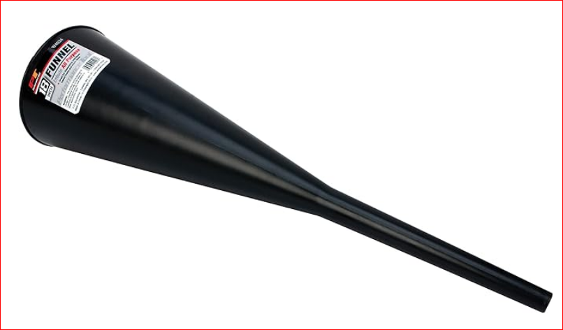

On BX's - I find this works well

Looks good. Ima order 1 of those.

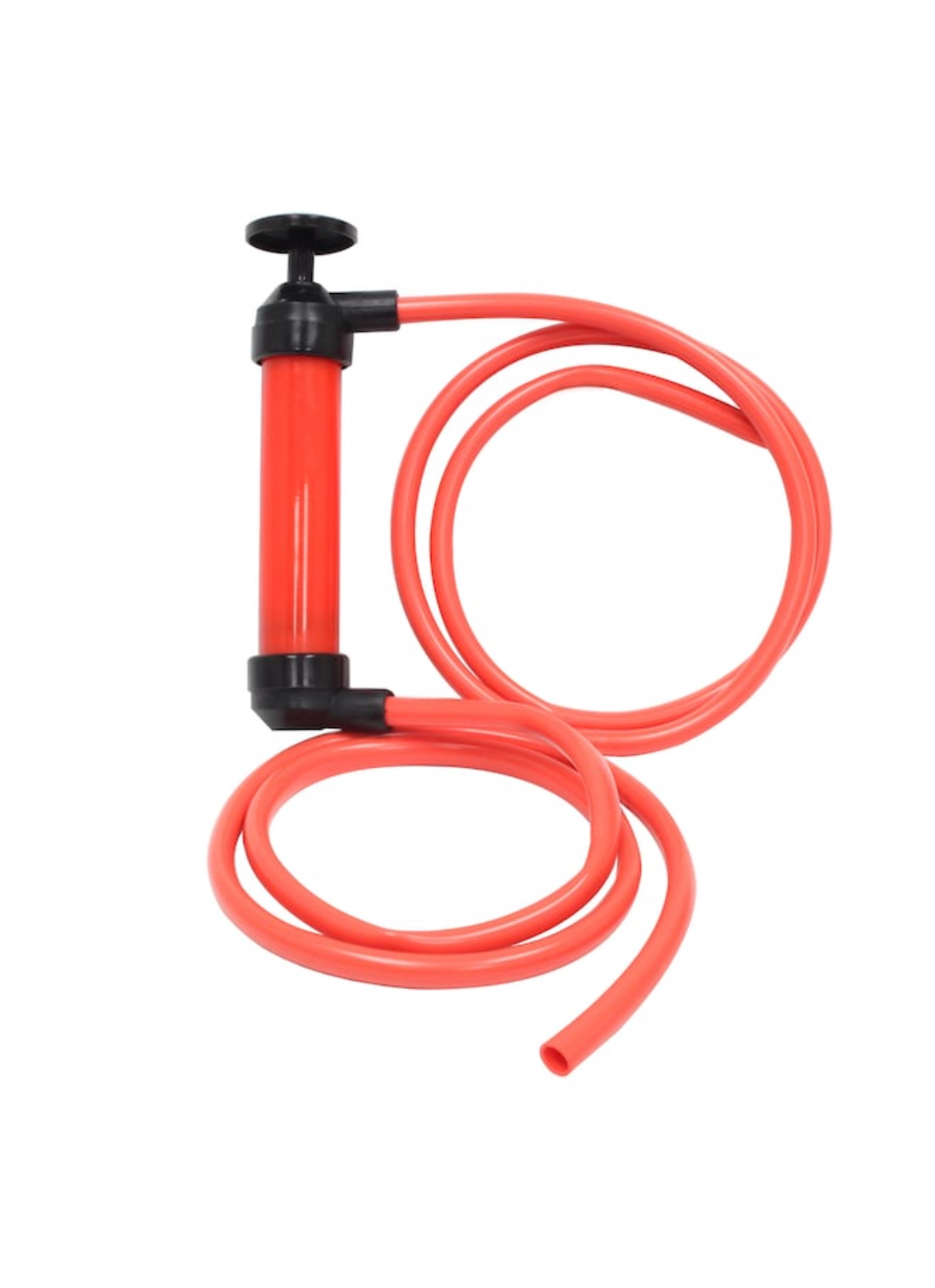

Paid something like $15 to $20 for a cheap pump/siphon. Had about 10 gallons to remove/replace at 400 hour service. Made pretty quick work of it. If I did that daily it probably wouldn’t last long. But I don’t do that daily.

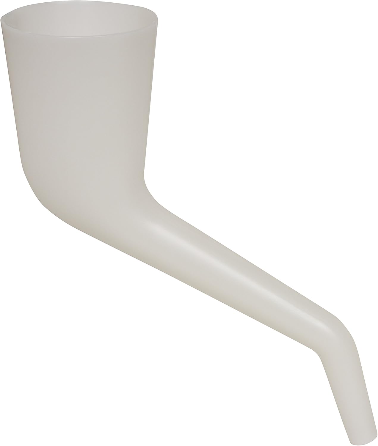

Lisle 17232 Right Angle Funnel
Great idea, but out of my price range at $999.99

I use one similar to this on my L.
But that Lisle right angle one looks "interesting".
Edit: I found it so interesting that I bought one....hahah. BTW, they are $11.44 at the Big A, so I got one on the way
