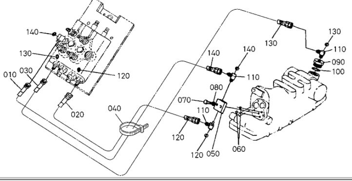

My name is Barry, I have a L2600 with a front end loader. I need to know where the 3 hoses that go from the loader joy stick box back to the side of the transmission. It’s a 9210 control box. Or maybe some one can tell me where I can get a diagram on the hydraulic lines. Thanks

Do you have an operators manual? They generally have the points marked in the manual. What model loader do you have?
I can't see an ops manual on the net with a quick search, if you don't have one, send North Idaho Wolfman a message and see if he has one squirreled away.

This should be what you need to know:
If you need more info just ask. ;)
