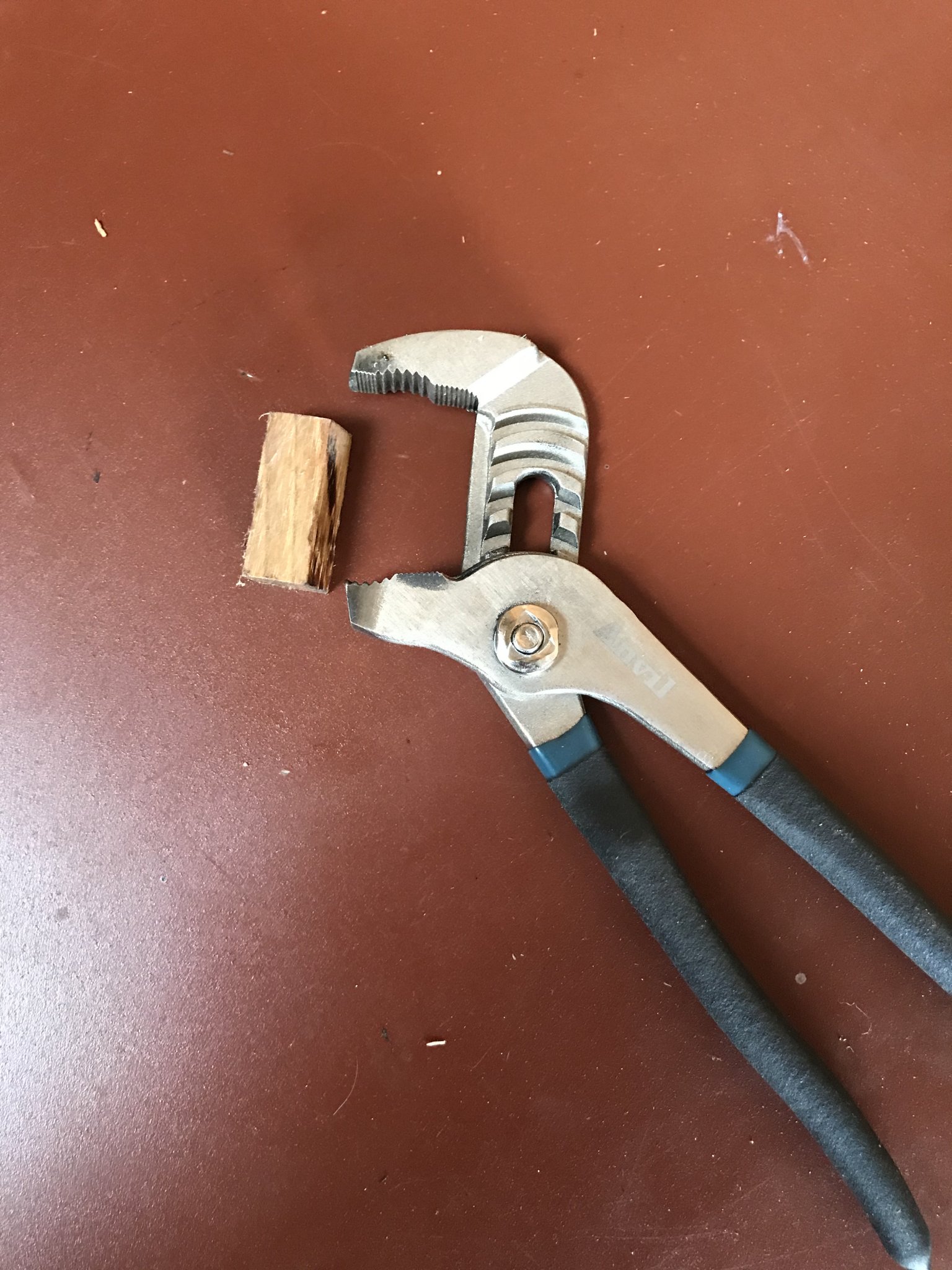

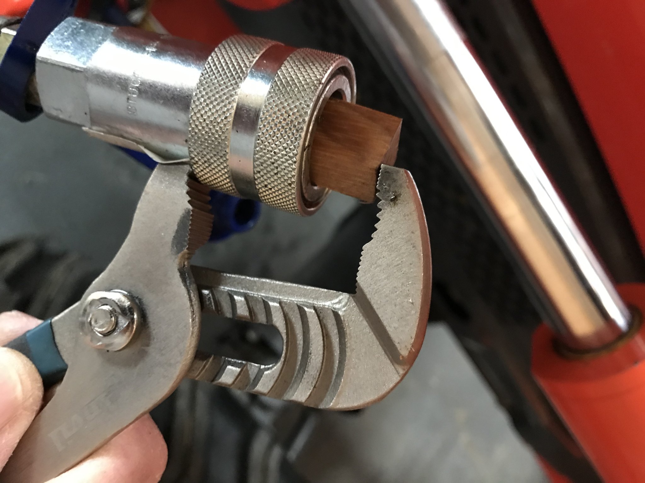

Use a piece of hardwood or plastic. I did damage with a piece of allthread. I modified a small cheap grooved pliers and cut pieces of hardwood from an old axe handle. I'll snap a pic next time I'm in the shed.
Edited to add pics. When in actual use, I wrap a rag around the end because it'll squirt pretty good.
