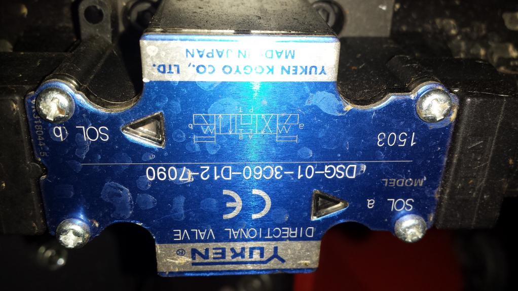

I am using the cylinders for angling, and I have an open center 4 way directional valve, my thought process was if A was energized B would be relieved and vice a versa. If I am missing something I am all ears. If that will not work I will need to spring for a double acting cylinder and rework my cylinder mounting point.
32,922
8,378
Give me the maker and model # for the valve and I'll look into it further. ;)
