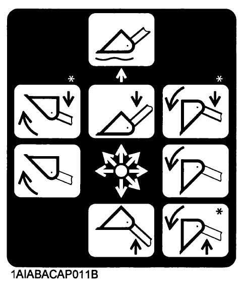

On another note, the control levers coming off the back of the unit at around 45 degrees seem to be working in the opposite direction than I'd expect. I'm wondering if the hoses have been reversed. For bucket lift, I push the lever forward/up, to drop is backward/down. For bucket curl up, I push the other lever forward/up, to curl down is backward/down. Can someone verify whether this is right?
Here is the normal operation for a loader. Not sure if this applies to your specific loader. You should see a sticker like this somewhere on your loader.
As old as the loader is now, all of the stickers are weathered beyond recognition. I don't even know what model it is. It has individual levers for lift and curl and not a single one that operates both functions.
14,224
6,392
Typically, when you push the lever forward the bucket should lower. As you push the lever "further" forward it should go past a feeling of resistance, and that is your float position. Sound like the hoses on that spool are reversed.
