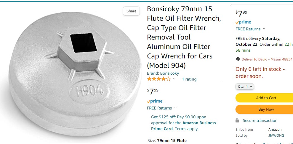

I used this. It's a tight fit on the filters but on an LX it fits all 3.
I did have to tap it on the filters an 80mm one might work better. But all the 80's I found were steel with a lip that stuck out towards the OD at the filter end.
On my LX2610 the lower radiator hose is tight to the oil filter. I did not want to take a chance of the filter wrench cutting into the hose...
