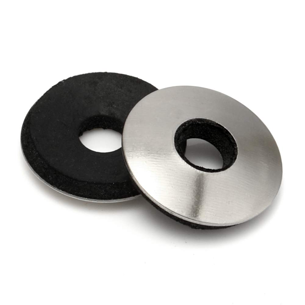

I think Mikester is referring to a steel washer that has a molded neoprene EPDM on one side. They seal good!
If possible, would someone offer a bit more info on these washers...that is the steel with neoprene. My "repaired" dripping drain plug is beginning to drip again. Wouldn't you know it? Never pays to get too haughty about repairing something, but I digress. It is not much of a drip as in the past but I want to fix it. These neoprene washers seem like a good thing to try.
I went to Lowe's yesterday as their site says they have these but upon further examination, they do not have a large enough diameter for the drain plug. It is 12.5mm. I looked briefly online but the description is not enough for me to know what size to locate. The Lowe's largest stock was #8 but I don't know how to interpret that number. It would not be metric. Any help for the correct sizing for a 12.5 mm drain plug would be great as I would like to try this. Online has boxes with multiple washers. I would only want to buy 2 or 3, at most. Thanks for any help.

Hi @Tractor Gal
12.5mm is about 1/2 inch.
These washers are Belleville washers due to their concave shape.
Check this out https://www.bsstainless.com/american-screw-sizes
and
It appears there isn't a number for 12.7mm
But there are Belleville washers for M12 bolts and I cannot find a number for bonded epdm at 12mm.
It seems #14 is largest.
Maybe someone knows if they exist.
In lieu of that, you could use some epdm or similar obtained from a hydraulic shop (cut your own) and a regular 12mm washer - a thick one or double up 2 thin ones.
Another possibility might be copper crush washers such as those used in motorcycles for oil drain plugs.
I used that concept on some worrisome hydraulic lines that wouldn't seal correctly.
Well heck - check this out - note the title to search on "
Bonded Sealing Washers M12
