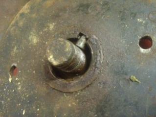

I have a deck that has 2 of the 3 spindles with bad bearings.
I have the bolt off of all 3 [figured I would replace all the bearings at the same time].
I am having no luck removing the pulleys.
I see the keeper but have no clue as to how to get any of the pulleys off.
I have tried PB Baster, heat....I do not own a pulley puller. ..However it seems as though they are on so hard that I may damage the pulley.
Any suggestions on how to get these off and then how to replace the bearings would be greatly appreciated.

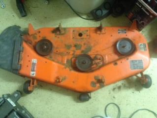

The deck is off my Kubota T1560. I can't seem to figure out how to add things to my profile.
I need to do some bearing work on my 48" deck that is on the B1550 also. Figuring on having issues with that one also. Both of these machines are new to me this summer.
Anyhow, I have attached the pictures. Not sure how to embed them in the text here.
Any help/comments/suggestions/cheap shots are gladly accepted.
Thank You.

Ok the deck your working on is a RCK44LT, First get some PB Blaster, stuff works like a charm, soak the spindles were they go threw the pulley and let them soak for a day or so, get 2 or more blocks of 4x4 wood or such, to support the deck right under the pulley (make sure the blocks are large enough that it keeps the skirt of the deck off the ground) on each side of the spindle that you want to get off, reinstall the nut will it's flush with the top of the spindle shaft, whack it real square and hard with a good sized hammer, the pulley should pop, then remove the nut and disassemble, if it still needs to be driven off more use a brass draft punch to keep the threads of the shaft from becoming damaged.
I've had many a spindle shaft that just wouldn't cooperate and had to be cut off and out, depending on the age and condition you might just have to beat the shaft out and get a new shaft and maybe even a pulley.

it is possible that the two holes were intended for pulley removal. If you can get a nut between pulley and frame then a steel bar with two holes drilled to spacing of pulley holes, two suitable bolts and tighten bar against shaft.
hope this is understood
cheers

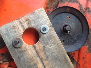

I soaked it in PB Blaster overnight and tried again today...no luck.
That tool is exactly what I was dreaming up....I made this wood one to hold the pully so I could get the nut off the top.
I am gonna see if my buddy can weld me one up.
Any other thoughts from folks.

Keep going with the PB Blaster and patience!
You may want to try spraying it and then lightly tapping on the pulley to vibrate it and allow the penetrating fluid to soak down.
I have also hung the weight of the equipment on the pulley you are trying to get off. Then gravity is working on it 24 hours a day while you are stewing over it at work! Don't lift it too high off the floor there is no benefit over a quarter inch or so.
