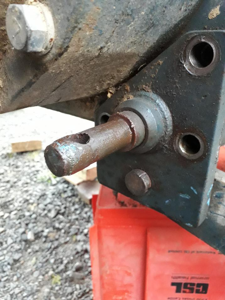

Well I'm baffled as to how to get this plate and pin assembly off. I've undone the 3 bolts and smacked it with a special tool, levered it with a crowbar and sworn at it but it won't budge. I want to get it off so I can free up the the drawbar assembly lower pin (smaller pin visible below the hitch pivot pin) that is seized on this plate. From the parts and workshop manuals it looks like the hitch pivot pin goes through the plate and is spigoted into the gear case, so the pin and plate should come out with a bit of gentle persuasion, but I can't get it to move. The 3 retaining bolts weren't rusty so I don't think corrosion is the problem, but it's locked solid.
Anyone got any ideas about how to get it off?
Thanks in advance!

Have you tried saturating it with something like Liquid Wrench? Just because it doesn't look like it is rusted doesn't mean anything.
If that doesn't help, then I would try using a blow torch on it.

Thanks mickeyd. I tried spraying it with kerosene intermittently over a few hours, a week ago. Maybe I should try that some more. My blowtorch is too small to have much effect on this.

A twisting motion might help free it from the bore behind the plate. I'd try using the biggest pipe wrench that will fit (see sketch) on the pin boss at the plate and lift up on it. I'm thinking about a 3-4 foot wrench handle. It might help to grind a couple flats on the boss. The plate and boss are very strong there so it will stand quite an up-force. Once it starts to move it should keep moving easier. I wouldn't put a big wrench directly on the pin - could wreck it.

What your not seeing is that the pin also extends out the back and into the gear case and that where it will be rusted in.
Spray it down with rust breaker, and do as rbargeron suggested.
Do not hammer it up or down or you could crack the case.

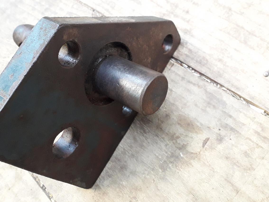

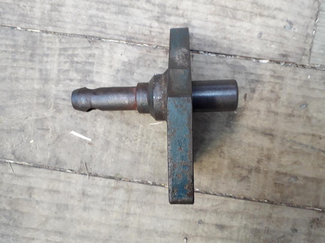

JOB DONE! Thanks guys, it's first time I've used the acetone/ATF mix (I didn't have access to P Blaster or other penetrants), and the pipe wrench worked a treat.. Once I had the pin assembly rotating slightly I still couldn't get the sucker to move outwards, so borrowed a jack (keeping in mind warnings about breaking stuff) then with light tapping on the pin while inching the jack got it out.
That pin was only lightly rusted on the surface, but it extends a good 1.5" into the gear case, and it's a snug fit in the housing so with all that surface area I can see why it was reluctant to move. And why attacking it the wrong way could bust the case.
The other interesting thing for me was that I reviewed a parts drawing I had before starting out on this journey, but it was only after having another look at rbargeron's attachment that I realised I had underestimated how much would be embedded in the gearcase.
