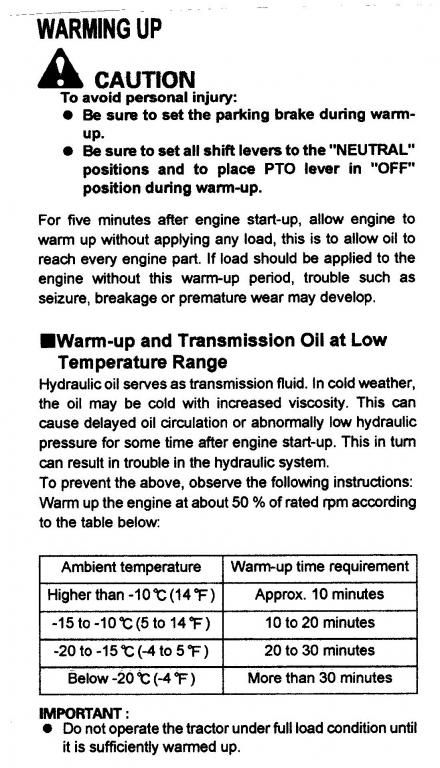

In reality you don't want faster heat because the hydraulic fluid will still be bone cold. If you read your owners manual it plainly states in there about warming the unit up, longer times for colder temps.
Maybe that is why mine have lasted so long and been trouble free. They always get warmed up in cold weather before operating.
Like Skeets said, go have a cup of coffee or hot coco with the heat on and blower on low. By time you have your beverage, it will be warm and more importantly, the hydraulic fluid won't be stone cold.

All agree that the transmission (particularly the hst) needs warming up at 50% of the rated RPM, which is about 1300. I generally run mine up to 1500 during the winter warm up. In warmer temps I skip a warm up period and just don't work the tractor real hard for the first 5 minutes or so.
