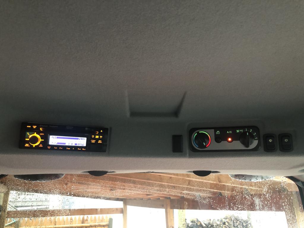

What is that toggle switch to the left of your temperature control ?
Just a blank where the switch for rear defrost would be if my tractor was so equipped...

I'll see if such a fuse exists, but there is no switch to turn on. Maybe it automatically turns on when heat is selected and the fan switch is turned on. Here's a picture of my climate controls:
Is that a recent picture of your climate control panel, as in today or yesterday? Noticed temp switch is all way to warm. If it is your A/C lighted push switch is lit meaning A/C is on. Push switch and it will go off, light off and A/C off. Could this be why it is taking so long to heat?
That's not the problem, if it's operating correctly. I run my AC with the heat control turned up in the winter for removing moisture from the cab.
The cab specific manual does mention that operating with the recirculate switch"on" will warm the cab up faster.

I plan to use the tractor when I get home tonight. The temp is currently 15F so it will be a few degrees colder later.
I'll time how long it takes for the temp gauge to come up, for heat to start coming out, etc. I'll try to take some pics of the dash so you guys can see the clock and temp gauge.
The A/C button shouldn't have any affect on the temp with the control all the way to the hot side, other than perhaps dehumidifying the air if the A/C compressor kicks on (which it won't at these temps). It was on when I bought the tractor new and have just not shut it off. Never used recirculating either.
