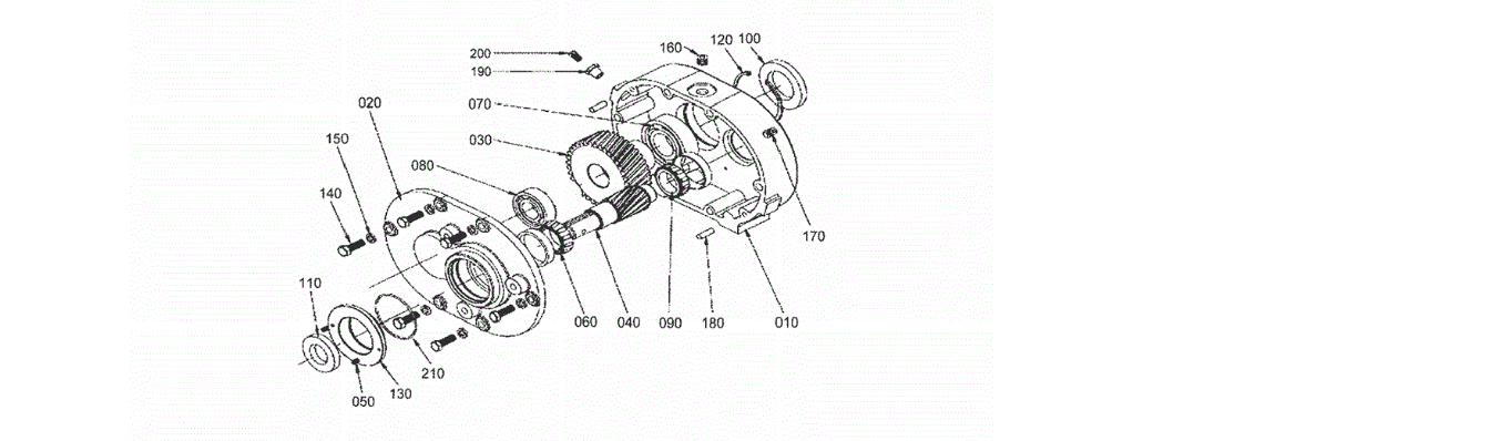

Looking at pictures of the blower there should be a vent on top, a fill plug on the side and a drain that is sorta near the bottom but still on the side. Oil should be filled to the point that it starts to flow out the fill plug. Not the best design as you can't drain all the oil out. This shows the gear box on its side as #170 is the drain. Or do you mean the small gear box?
Thanks! On my implement, I have only one gear box. there is a drain plug at the bottom of the gear box. I also have the two other plugs on the side as you discuss.
