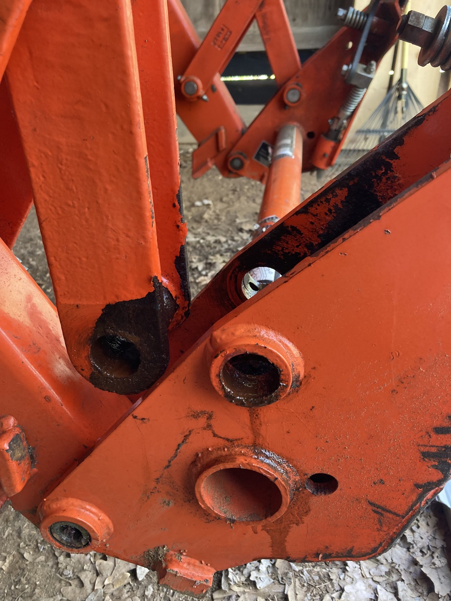

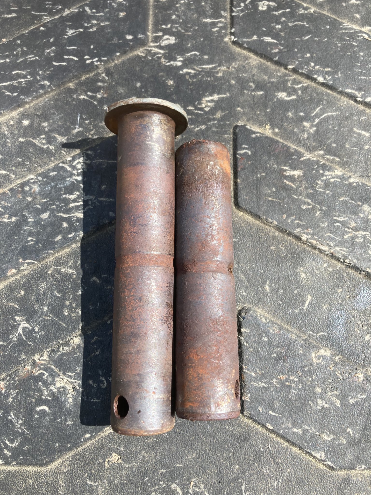

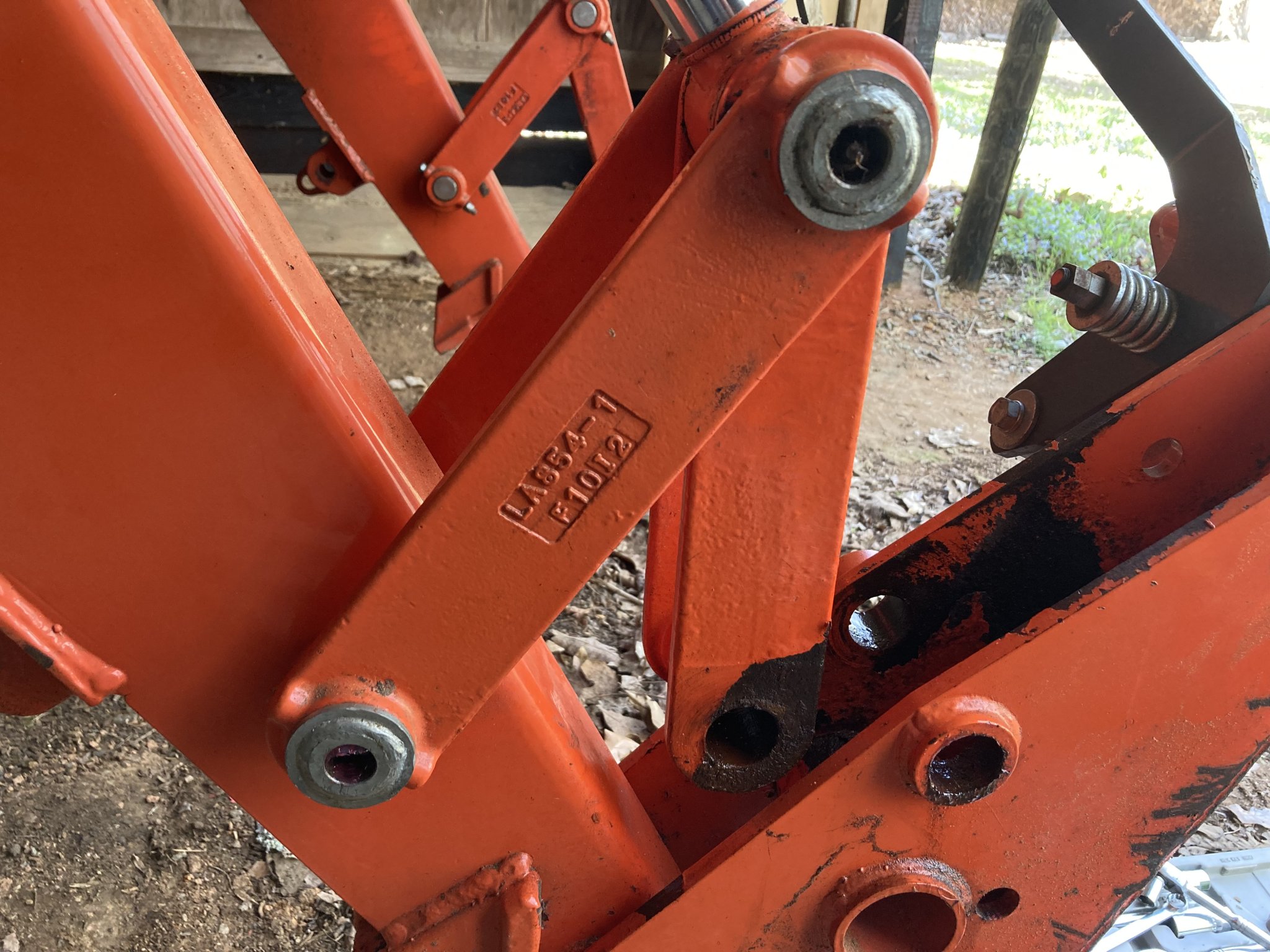

I was greasing the loader today and discovered a missing zerk and one zerk didn’t take grease. I put in a new zerk and still wouldn’t take grease. I couldn’t get a zerk to grab in the other pin. The hole is too small, but I can’t tell if the previous one broke off.
what do new pins cost? Obviously they have not seen grease in a while. I opened the grease hole with a screw. They were both packed with rust.

I would clean them up with a wire wheel and clean the grease passages. Get new grease fittings installed and put them back into the machine. If they are loose then replace them. If not you dodged a bullet and keep greasing them going forward.

Thanks, I was able to find them and it’s $15 and $30. A dealer is close by, so I’ll try them first
Are these parts a dealer would have in stock?

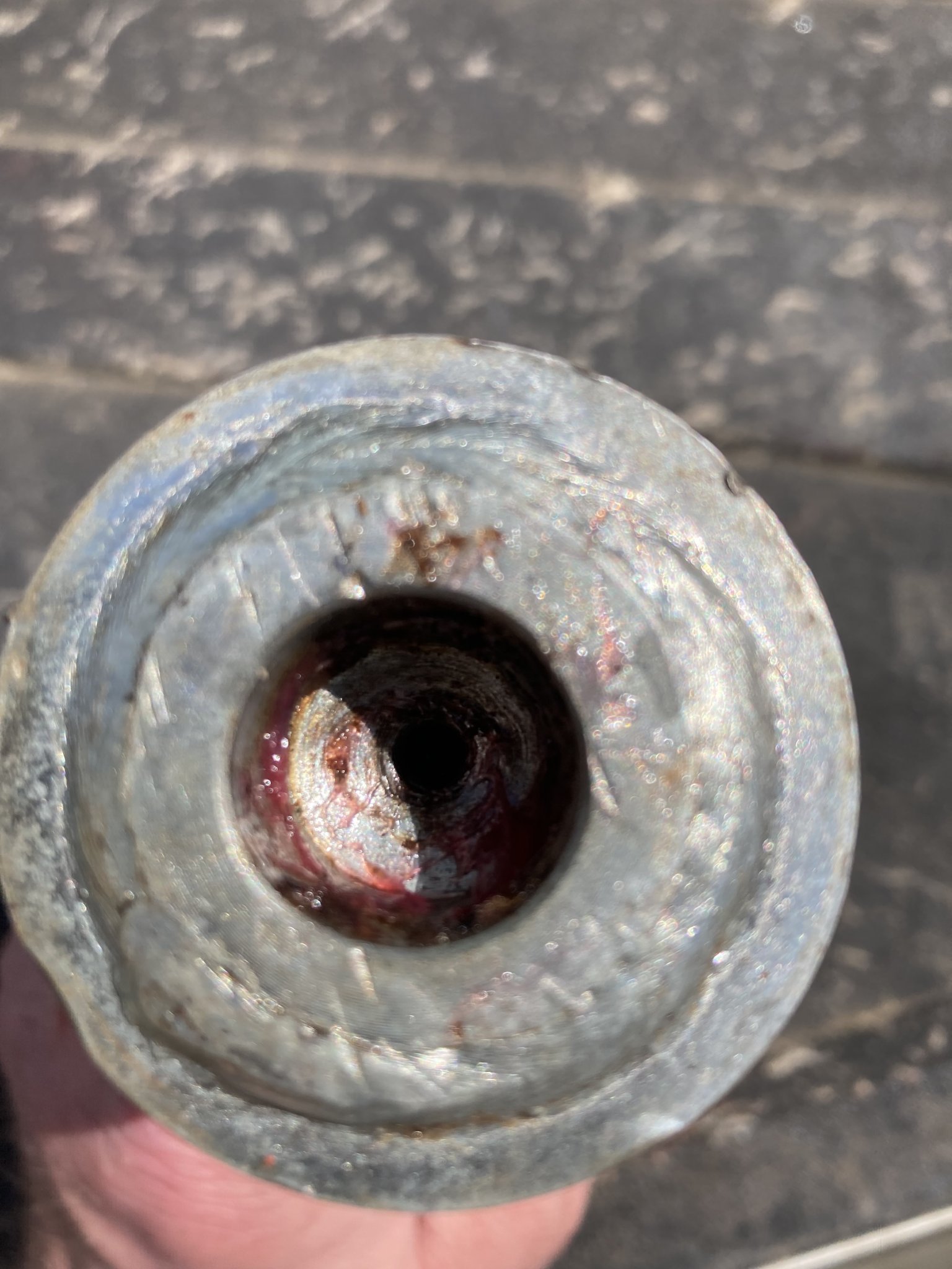

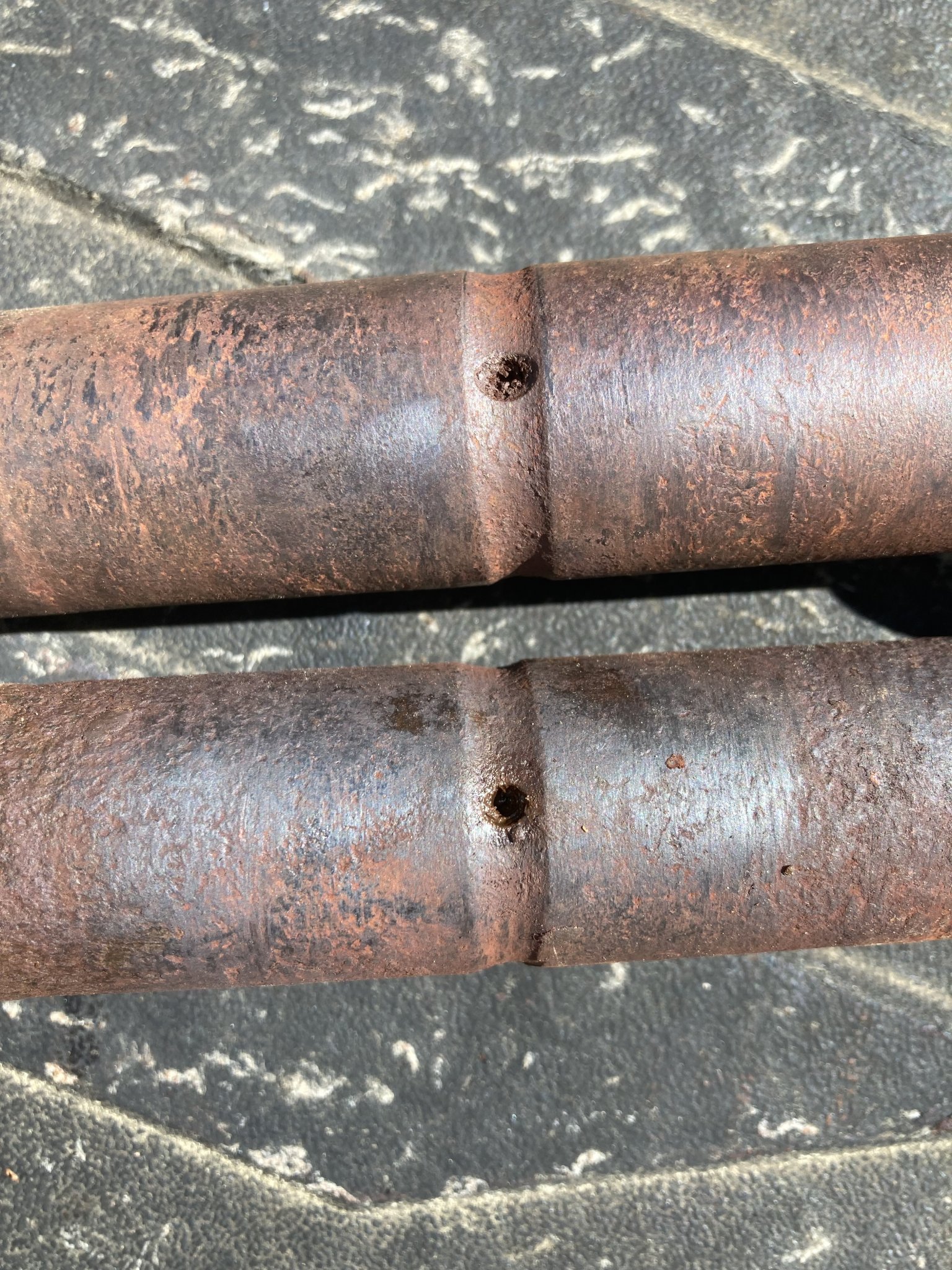

View attachment 125842 View attachment 125843 View attachment 125844 View attachment 125845 View attachment 125846
The fourth picture looks like the zerk broke off in the hole. Maybe you could drill it out to clear the passage and use an eze-out to remove the zerk.

Put the pins in vinegar (acid bath) for a couple days. Clean them off and see what you've got.
I'd say redrill and tap new zerks after that, reinstall, and go do tractor work.
Drill out with LEFT HAND drill bit.
Ez- out then perhaps not necessary!

I'd do as others have suggested, clean them up and use them, but for $50 maybe just replace them!

I cleaned one and cleared the grease tunnel, so it’s functioning properly. It was a ckskr to reinstall so I’ll assume it’s not to loose. Thanks all for the suggestion. At least $15 saved so far. On the second one I will try ez out. I can’t imagine it’s supposed to have a zerk thread diameter different from the others. I’m thinking the zerk broke off.

No reason to know if the existing is metric or standard. No need for easy-outs.
Redrill and retap new holes for zerks you have on hand.

It's not rocket science, my friends. it's getting grease into a swing fitting.
Just drill a new hole and then tap it to the zerk size you want.
The previous zerk holes will only help.

Looks like I'm in the minority here; I'd replace those instead of reusing even if they were expensive.
That's basically a bearing surface. The holes they go in are rotating around the pin in use. The unevenness will wear the hole faster, even with grease.
To me something like that is an automatic replacement.

Relatively easy to drill a new hole to the grease galley if it's along the shaft. Much more difficult if you're drilling into the end.
Not to mention grease fittings usually (always?) have very short tapered threads. Tapping them can be a pain even if you're experienced.
Unless the fitting is really in there hard it's usually easier to remove the broken one and reuse the existing hole.
Left hand drill bits are the cats axx for this job!
Yup! LH drill bits and wax (crayons/canning wax) are often forgotten essential tools.
