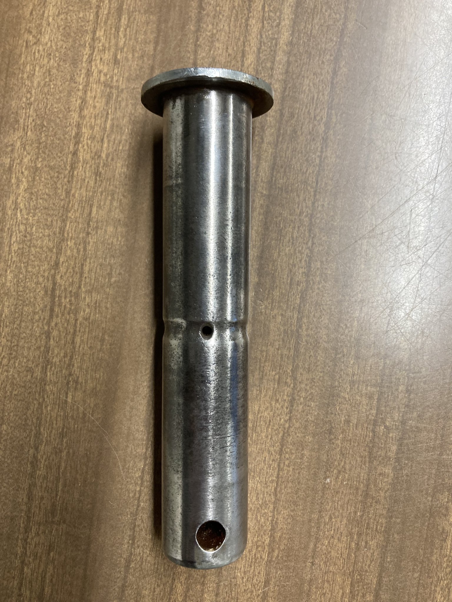

How much for new loader pins?
4,065
5,492
I would clean them up with a wire wheel and clean the holes up with a piece of red Scotch-Brite attached to a drill. I would spray penetrating oil in the holes while working the drill motor back and forth. (Not too much though, just to clean them up a bit)
(I keep an old "wheel cylinder hone" laying around for just such an occasion, but the Scotch Brite works pretty good).
Replace the zerks.
Then wipe, clean, grease, reinstall and check for 'Play'.
My bet is that they will be just fine.

I would write Kubota to complain that the zerks fell out or broke off without ever being used...
I blame the dealership that I bought it from. I requested service before delivery and they at least hit the convenient zerks, but obviously ignored the missing and clogged zerk.
6,897
4,228
Those rusty pins didn’t “just happen” recently…those been rustin’ a long long time.
Greasing tractors is a job some people simply don’t like to do…. and dealerships employ some of those guys. When I dropped my K off at the dealership for a new steering cylinder installation…they did a “complimentary wash and grease” job.
Result? : A wet tractor seat and some kind of red grease ..ON TOP of SOME zerks.… and lots of zerks still sittin’ with black greasy dust on ‘em …just like they were when I first loaded that tractor onto the trailer to take it in.
(I do my own greasing and do it about every few months …because I only put about 50-75 hours/year on the machine.)

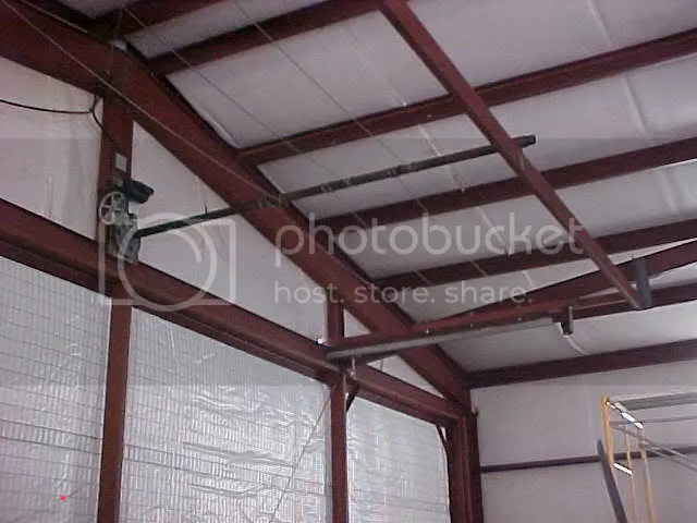

In a somewhat-related comparison…. I have a hangar door which I designed/built and it gets greased once/year… MAYbe…. and it’s been there 24 years …running on Grade-5 bolts 3/4”….(a total of 8 separate bolts and 12 sheaves running 3 cables counter-wound on the 2-1/2” pipe spindle)…. on plain steel sheaves/pulleys…operated by a cable-lift boat-lift system I modified.
That door weighs 2500 lbs and is operated about 2 or 3 dayes per week…so a bout 1250 cycles now…
I cross-drilled and center-drilled the bolts and threaded a zerk-fitting in the end of half of them…. the others…I simply loosen the nylock nut..slide the bolt sideways within the sheaves/pulleys…and paint a little grease on them with an acid-brush.
Almost No Detectable wear on them after 24 years.

Now my curiosity is up…
In the background it appears to be another pipe with cables attached to it but driven by the same boat lift. Please give a diagram or description of what is happening.
From the other picture I see (assume) the cables are through the wall, extend a little bit and then run over a sheave down to the door front. I assume the door is lifted by the tension on the cables and then held open by the boat lift (since I know they reliably hold boat above the water for long periods of time with no problems). I further assume that gravity still works well and the cables will just lower the door.
Perhaps the lift of wind would blow the door up or something like that and those cables are the closed position retention mechanism???

Not sure I understand your question… The boat lift tensions the cables and lifts the door…which tilts inward and lays horizontal as it lifts. Gravity (and the reversed lift) lowers the door…and since the cables are attached slightly below door-center… holds the door closed.
Wind merely holds the door closed… more Firmly…since the door is resting on steel-wheels (at each end) …which are slightly above door center. … (gravity is your friend)

What is going on with this area in the photo? What is the pipe looking object for? Are there cables in those highlighted area? What do they do?

That is not a “pipe”…. it is a 4” square-tubing…thru which vertical holes are drilled…thru which bolts (for sheave-axles) are placed…. the cables are counter-wound thru the spindle…then turn 90-degrees to run out the front of the bldg….turn down over sheaves…to lift the door.
OK, Russell…. I see your question now…. What you are looking at is trolley-tracks welded up beneath some square tubing. The Top of the door is chained to trolley-wheels (such as might be used on a side-sliding barn-door)…so that as the top of the door comes inward …that door-top is suspended by the chains…and the trolley allows the door-top to come into the bldg.
The door is 44’W X 14’ H…. and is picked up by the cables 14-inches below center…. so the trolley is only holding about 150 lbs of door weight. The trolleys are rated at 600 lbs each…and I have dual trolleys at EACH side…. about 1200 lbs of capability holding only about 150 lbs.
The cables are 7/16” aircraft cable… three of them…rated at 7K lb working load each…lifting a 2500 lb door…. so 21K lb capability … with triple-reduncancy…. counter-wound on the spindle…in-effect almost 42K lbs of lift capability… They’ve shown zero wear in 24 years….but I replace one each of the three every ten years.
