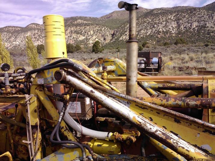

I have a very old bit of Orange iron, AC Orange, not K Orange. (Orange seems to be a great tractor color!)
My father and I adjusted the valves on this old girl about a year ago and it got a little power back. I'm not sure your pressure problem is age, this gal has been around for 60 years and no pressure problems at any RPM's. You might have a pump or bypass problem. Certainly change the oil and filters. You could be running too thin of an oil as well, make sure you're running the right oil for the engine.
Old tractors will run as long as you care for them. The attached girl won't start even hot without starter fluid! :eek: Talk about no compression!
