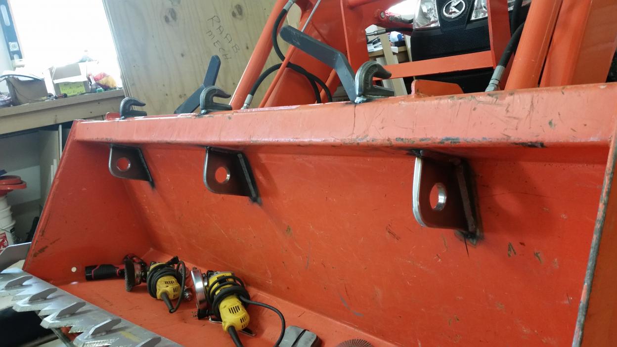

Lots of great discussion and points made in this thread! I myself went the welded route. These are stick welded with 7018 rod. Here's a couple pics after a quick coat of primer. I just picked up some Kubota orange and will shoot them once it warms up a little.
Sorry for the picture size, I uploaded using the app.

mighty puuurddy welds there too!!!:)
they aint going no where! :D:)

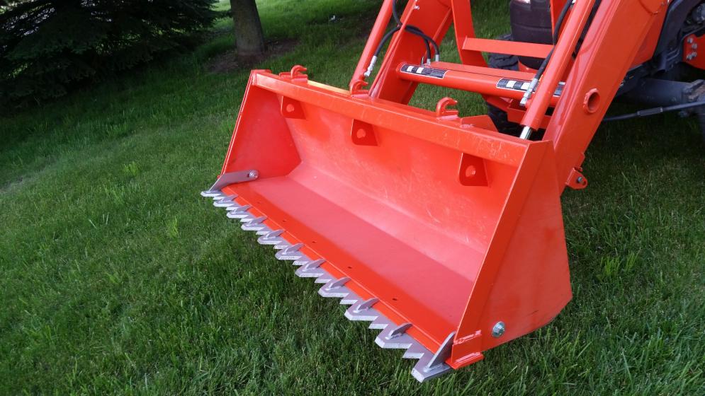

Notice BB's bucket isn't the light duty one, so the metal comes all the way up the back and across the top. The metal is also much heavier. Makes for a stronger weld and much less chance of any trouble.
