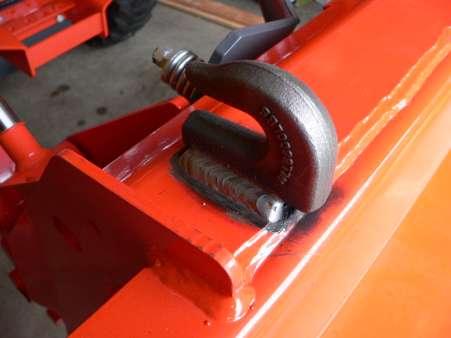

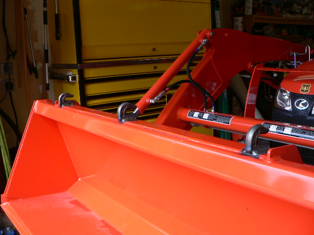

I always weld mine on. It's a lot easier and less expensive than bolt on. I put 3 across the top. The outside ones are to strap things in the bucket like barrols or to hook the extra chain up to keep it out of the way. Always put the lifting or pulling load in the center of your bucket to avoid damage from putting to much load on just 1 loader arm.
I also welded mine on. Used the 3/8 hooks, works great with 5/16 chain too. I welded 3 on, 2 outers right in line with the curl ram to avoid twisting of the bucket and welded one right in the center too.
Nice looking welds! Did you not use the backer plate? I have a set of hooks and backers that have been sitting In my garage forever but my BXPanded have done just fine once I got them set up properly.
What’s the US forest service for?
Thanks for the compliments on my welds, I am a self taught fabricator too. And I see the ridicule one gets in here for poor welds on other post. :p
Actually a dealer tech for 32 years, mechanic for longer, but been metal fabbing for years. I built this trailer last year and I have some paraphernalia for my timber farm.
My Kubota is the larger L2501 and there is a huge plate on the top already, you can see the long weld in front of the hook. This was a thick plate. I did buy the original Kubota orange paint to finish the weld up. Caution, there is several shades of Kubota orange. I bought some of the OE Kubota gray in case I need that too.
