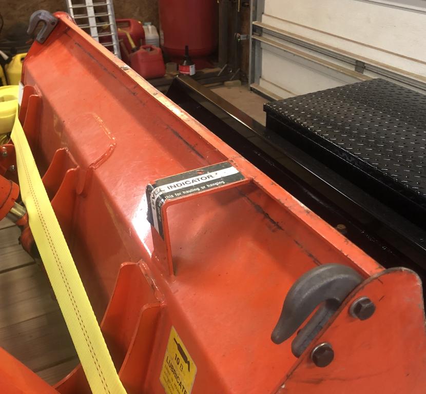

for those with SSQA bucket, bxpanded makes quick on/removable hooks too, they are awesome.
9,908
4,062
I made a pair of 'clamp on' hooks, though with version 2, I'm using a 3' length of electrical channel. Clamps slide on channel, channel slide into bucket, hooks slide to left/right edges of channel,tighten bolts..done.
I didn't have the heart to cut/drill/weld the bucket.....
Mine are similar to the BXexpanded ones in B737's picture, just a LOT cheaper. BX ones here, would cost north of 300 Canucks. If I'd bought new hooks and new steel , less than $40. As it was, I just used scrap laying around.Sad thing is you'd never know.....the pile never seems to go down.

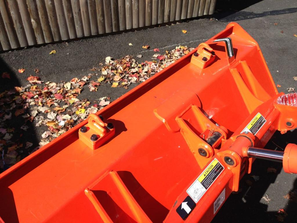

They also make them for the BX pin-on buckets, equally awesome. I like them because you can adjust them anywhere on the bucket, or take them off, in seconds. They are pricey, tho.

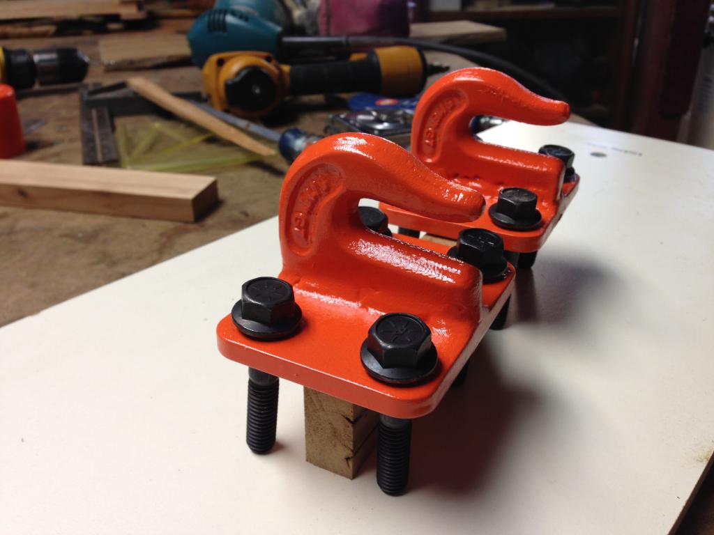

I bought Kens bolt on hooks and couldn't be happier. Well made product built specifcalily for your tractor. Tip don't be afraid of there blemish products. When got 1 and other than the color being slightly off looks like the other. I was painting mine anyway so I wasn't concerned.

I went with Kens bolt on hooks. Two hooks are nice when carrying stuff with the bucket.
