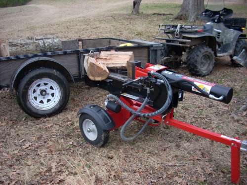

Pick up a Harbor Freight gas engine. I have a Honda 5 HP engine off of a power washer that's just barely broke in, but it's horizontal shaft. I can remember seeing a wood splitter with a vertical shaft engine.

My Troy Bilt has a vertical shaft with the pump attached to the bottom.
The bottom hydraulic hose is seen here coming from the pump.

Never saw a log splitter with a vertical shaft engine. o_O
I'd like to see a pic of that.
12,885
5,624
hmm, had to look again, to confirm, yes, post #8, show a troybilt splitter, in front of an ATV with trailer
maybe your puter is blocking the picture ??
7,835
3,064
No, I can see the full pic, just not enough detail- looks like just a black box. Having never seen one like it before, I couldn't make out the muffler, air cleaner, starter pull, etc..
After seeing pics on the website, I got it now.
