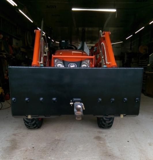

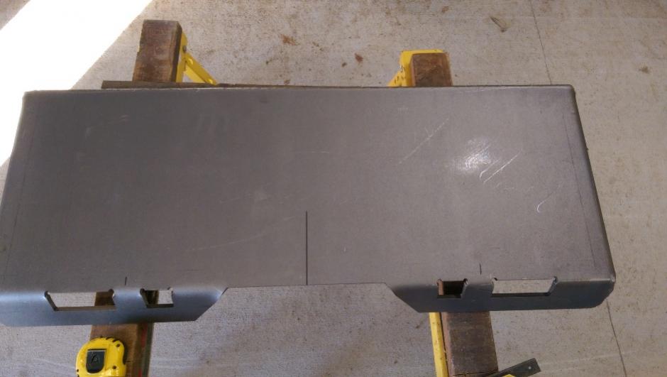

1st: its just a basic naked plate from TITAN in 3/8" thick all over. figured if it was thicker than any part of the tractor i probably wasnt gonna hurt it. Laid out where i wanted my forks to go (3 positions is what ive got with this set up)

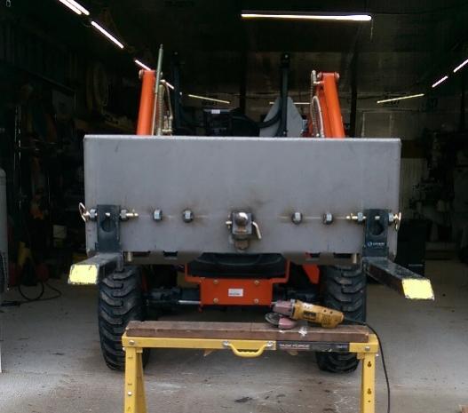

2nd: used my light weight TITAN forks that used to clamp on the bucket. re using old parts. cutting the back of these off took some time & several Metabo wheels.. but it works fine.

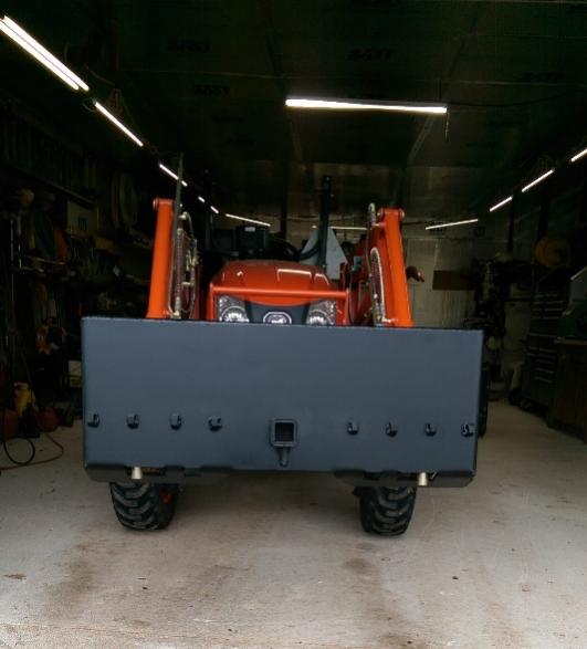

3rd: mounting was a bit of thought & i finally decided to weld on some 1" nuts. They are plenty strong & got about $1.50 in them. picked my height so that the forks can set flat on the ground & still have about 1" of my plate off the ground.
4th: im not a pro welder. my stuff is ugly, but it never comes loose. so it is what it is on the "gobstopper" look of them, but it was plenty hot & you could see the penetration/heat thru the 3/8" plate. & hey if one ever comes loose? this is easy to fix.
5th: had a 2" receiver stub laying around cut it off with just a little clearance from the forks & welded it with a support stub under it. figured that if it had good penetration to the plate & then an under mount that had good pen... it wasnt going to be an issue for me to move my empty trailer around.
then its just clean up & paint. here you have it!

I especially love picture #3: It looks like a badass SWAT team vehicle! ;)
Good job, I'm sure it will work out well for you.

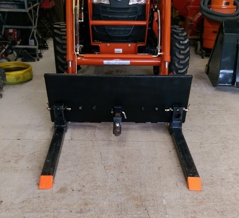

Ahhh.. sounds like projects like this call for a bucket/fork tip gauge....
YES i did put that on my level gauge.... if your looking at the picture head on its on the left... already had it marked for my bucket...
& as mentioned its a lot different mark for my forks/hitch.

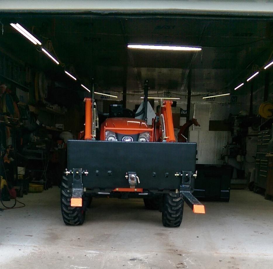

same pins.
you just put them in from the "inside" position instead of the "outside" one.
if you want the middle position? it turns out to be just enough room to wiggle them in from either direction.
if you had some really long grade #8 bolts or pins? you could catch all 3 at one time.
but im a poor boy & just used the pins they had at rural king/tractor supply.

thanks guys.
just went with what the guys here have showed me & tried to keep it really simple & cheap for those of us who dont need lots of adjustment or positions.
"wide" for me is for logs & stuff
"middle" for me is standard pallets
"narrow" for me is the small pallets & my wifes fruit picking position.
wife just hops on the pallet( & YES she does put a safety belt on to the bucket) then i can put her right up to the top area of our fruit trees for picking.
she also uses this for cleaning the windows on the higher side of the house.
for me the trailer hitch is more important for moving my trailer around without having to drive all over the yard, which makes her mad.
now i just drop it & then spin it in the driveway with the tractor which turns way better than my crew cab long bed truck.

got PM'd a question on how i picked my "nuts" for the pin holder..
:D
i grabbed those pins at tractor supply then stopped by the nuts/bolt bins & wetn over to the grade 8's & said: YEP the thru hole is big enough... grabbed a dozen & went from there.
that gives you a perfectly flat/square surface to weld to your perfectly flat plate & they have a little bevel already made into the edges so you can get a great weld even if you are just a puddle jumper like me.
