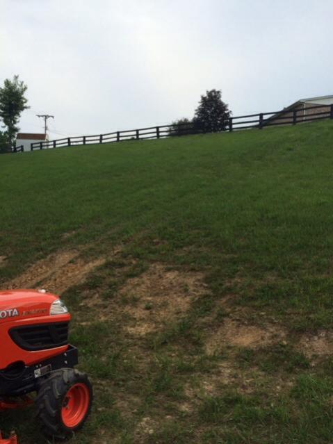

Here's my hill. I don't have a place less than 20 and the steepest part where I get stuck is close to 30 degree if slope. No wonder she won't climb. Glad to see others get the same response. My girl will do the 20 degree area in high but she don't like it. Lol.

that looks a hellva lot worse than 30 degrees! but pictures can lie too! I would be scared going up that sumbeeauch backwards!!!!!!!!!! Well I must have got a bum BX - my 15 degree hill stops me in high @ 3000 rpms......
looking at the picture again, look ver much like mine 30 also ....you have nicer grass!
glad to see someone else with flat lands! :eek:

Its prob a little deceiving but it is pretty steep. Enough to make my butt pucker when i side hill mow it. Up and down doesn't phase me unless i forget to lock in 4x4 and the rear wheels slide while going down. My old garden tractor would run away with me just about every time but i got used to it. Well i feel alot better after everyone has responded....was thinking i had done something wrong or my tractor was just a wimp!

If you are 'side' mowing that, I'd have a weighted, wheeled outriggers to give me some stability increase, that's a nasty slope to be mowing on. I'd only mow that beast up and down, not side to side, way too much pucker factor for me! :eek: Sorry, I'd terrace that puppy and plant something on that critter.
I can't speak to the HST, mine is the gear type, however, hydraulics being hydraulics... too much 'request' of the system will either put it into relief or cavitation. Either one is bad and I'd guess that's why backing off seems to help. Think of the foot pedal as just another spool lever, just a funny looking one. If you're digging with the loader or a backhoe and the digger stops while you are at full deflection of the spool lever, do you sit there thinking it will eventually start working again or do you back off and come back into the lever a bit more delicately? Apparently the concept is the same with the foot pedal, lots of smart cookies on this website!

Ive had the rear wheels lift up on me but since had them weighted. Not that bad except a couple place that "dip" and make ya pucker a little. im getting an tiltmeter for it soon can can let you know the exact angle after that. Im pretty careful myself as i dont want to end up dead! Always slow, with ROPS up, seatbelt on.

I would not side hill mow that hill ever. My butt cannot pucker enough!:D
