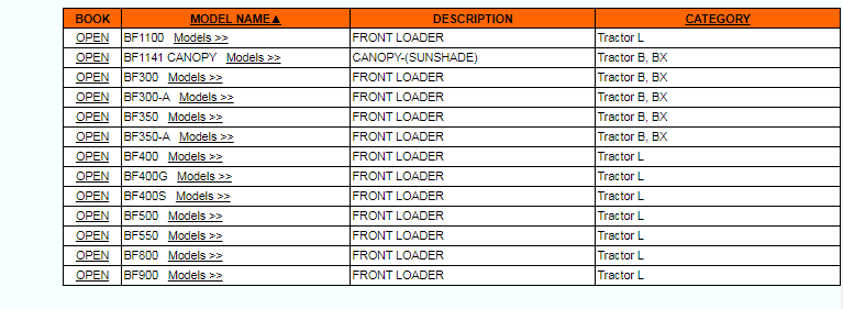

I'm thinking about adding a front implement on my L275 also.
You might find some OEM drawings helpful from other loaders here.
Here is the link and a few model names for loaders to search if you haven't seen this yet.
Good Luck.
Illustrated Parts List
