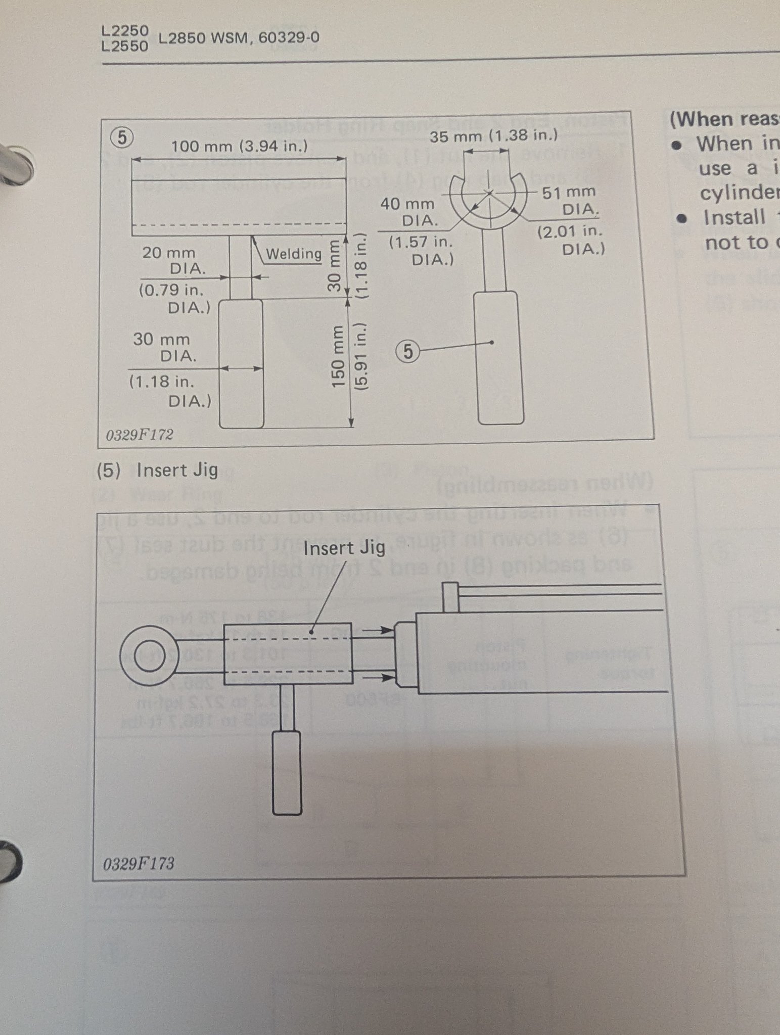

I'm about to do this myself. Here's the tool the manual recommends to tap down the end
