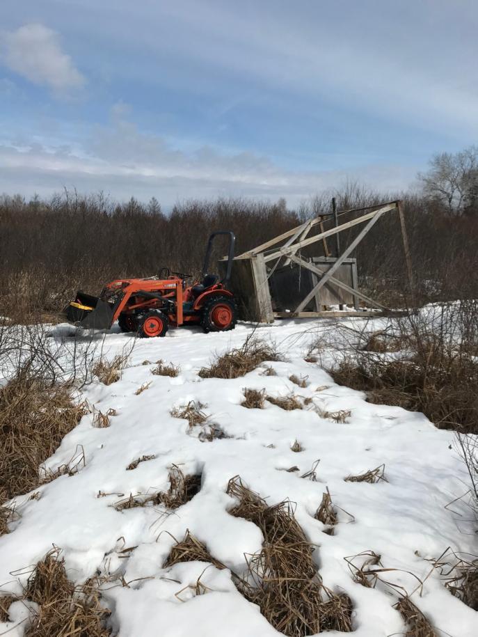

I've got a B7100, 4wd with R1 tires on it and I have been very impressed with what I can pull with it.
I have been able to pull my tower stands around with it, plus pull them up, once in position.

In the picture, looks like the tractor needs 'pulled up' too.:eek:
