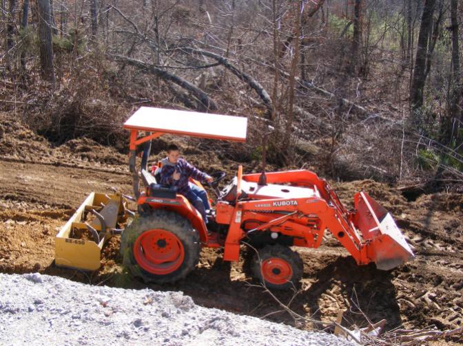

I would definately have to agree with the others. A box scrape would be the best choice as long as it's a good one. I had a off brand box on my B 7100 and it wasn't heavy enough to even drive the rippers in the ground. I didn't want to make that mistake twice so I bought a Bushhog brand to go on my L 3000. It weighs almost 400 lbs not only serves as a great counter weight it works great for its intended purpose as well. I have a shooting table I built that weighs almost 1,000 lbs. I move it from time to time and the box scrape keeps the rear tires planted fairly well. I load and move 4x5 rolls of hay as well and it handles that fine as well. I would go with the box if it was me.

I was a little off on the weight of my box scrape I posted before. I have a Bushhog BX 650 (5 1/2') and the real weight is 511 lbs. I have been very pleased with it for scraping and as a counter weight as well.
