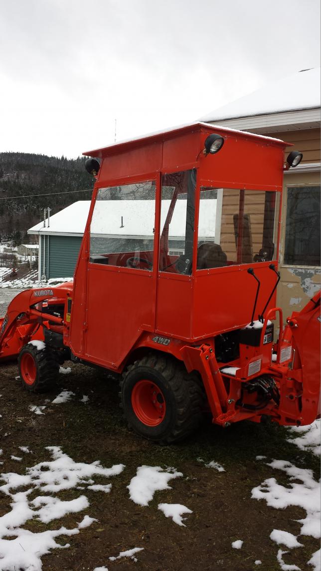

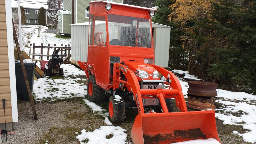

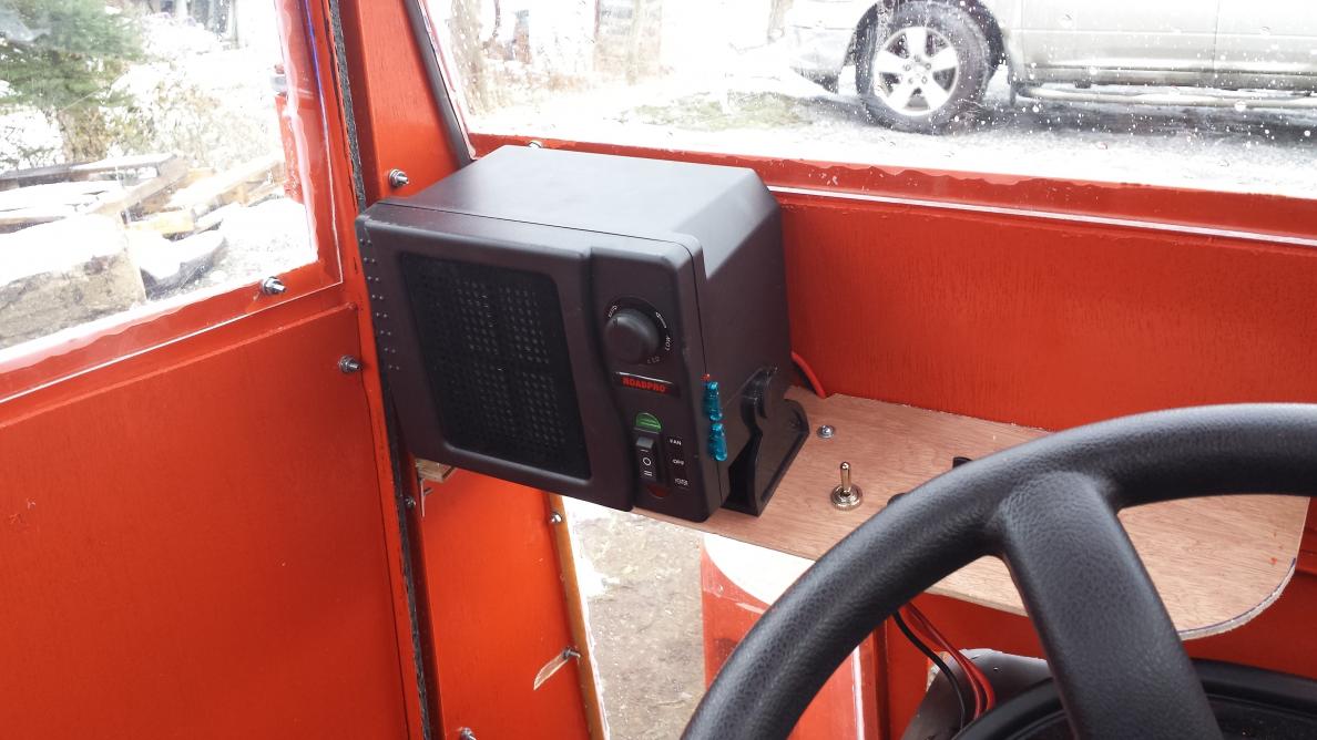

Here are a few pic's of what I have done not the greatest fabrication job but it works:D, Pic 3 is of the current electric heater I tried but found that on frosty days it just doesn't cut it, all I get is a small spot cleared in the front glass if I turn it directly at the window in about 30 min running time.

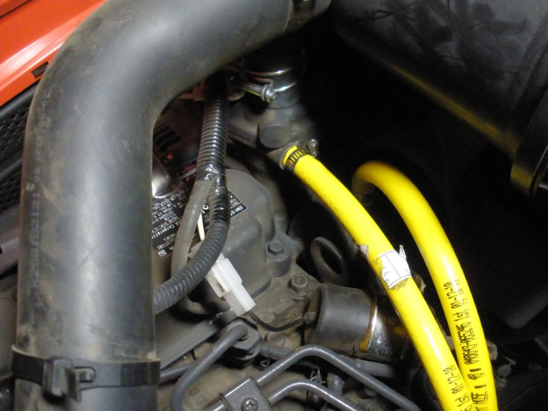

Here ya go. I don't know how similar the plumbing might be on your tractor, but this worked out well for me. There's a small bypass hose with a 90 degree bend. I disconnected the top/horizontal part and rotated it about 180 degrees so it faces in the opposite direction. I used an internal fitting to couple one hose to it and extend it to the cab. The other heater hose connects to where the short 90 had been. In the cab, I installed 3 small ball valves. One is for a bypass and connects to two tees on the engine side of the two that are shutoff valves to the heater. This valve is kept closed when the heater valves are open. When I removed the cab last spring, it was a matter of closing the two heater shutoff valves and opening the bypass valve.
Heater from driver's perspective
Looking in through right side door
Hose routing. There's plenty of space behind the lower cover
Top view of the new hose coupled to the existing bent hose
Side view. You can see the heater hose connected to where the original bent hose was
