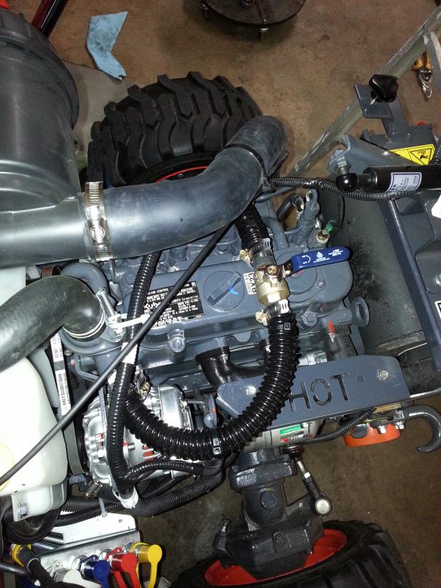

Here ya go. I don't know how similar the plumbing might be on your tractor, but this worked out well for me.
Thanks for the pics. mine is a bit different in terms of plumbing and space for the hoses but I think I get the idea. I like the 3 valve setup as it would save so much time in removing the cab in the summer months.

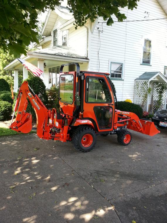

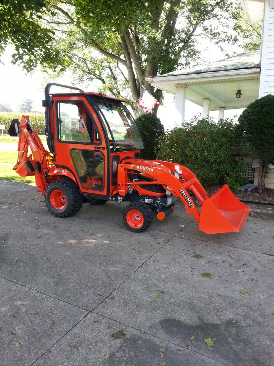

New guy here, with a 2013 BX25D, Curtis Cab (all steel), 20,000 btu heater,
Routed one of my hoses on top to the motor
Routed second hose under tractor to the lower radiator hose (easier)

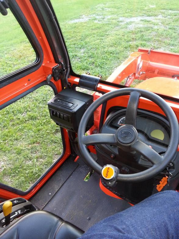

Factory wind shield motor
Deluxe over head console with built in fans.
