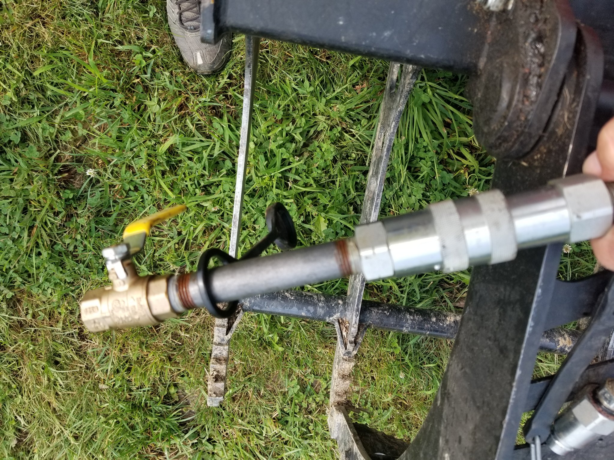

I made this. If the oil warms up after you unhook the attachment their is air in the black pipe so it compresses the air a little. never any problem hooking up.
