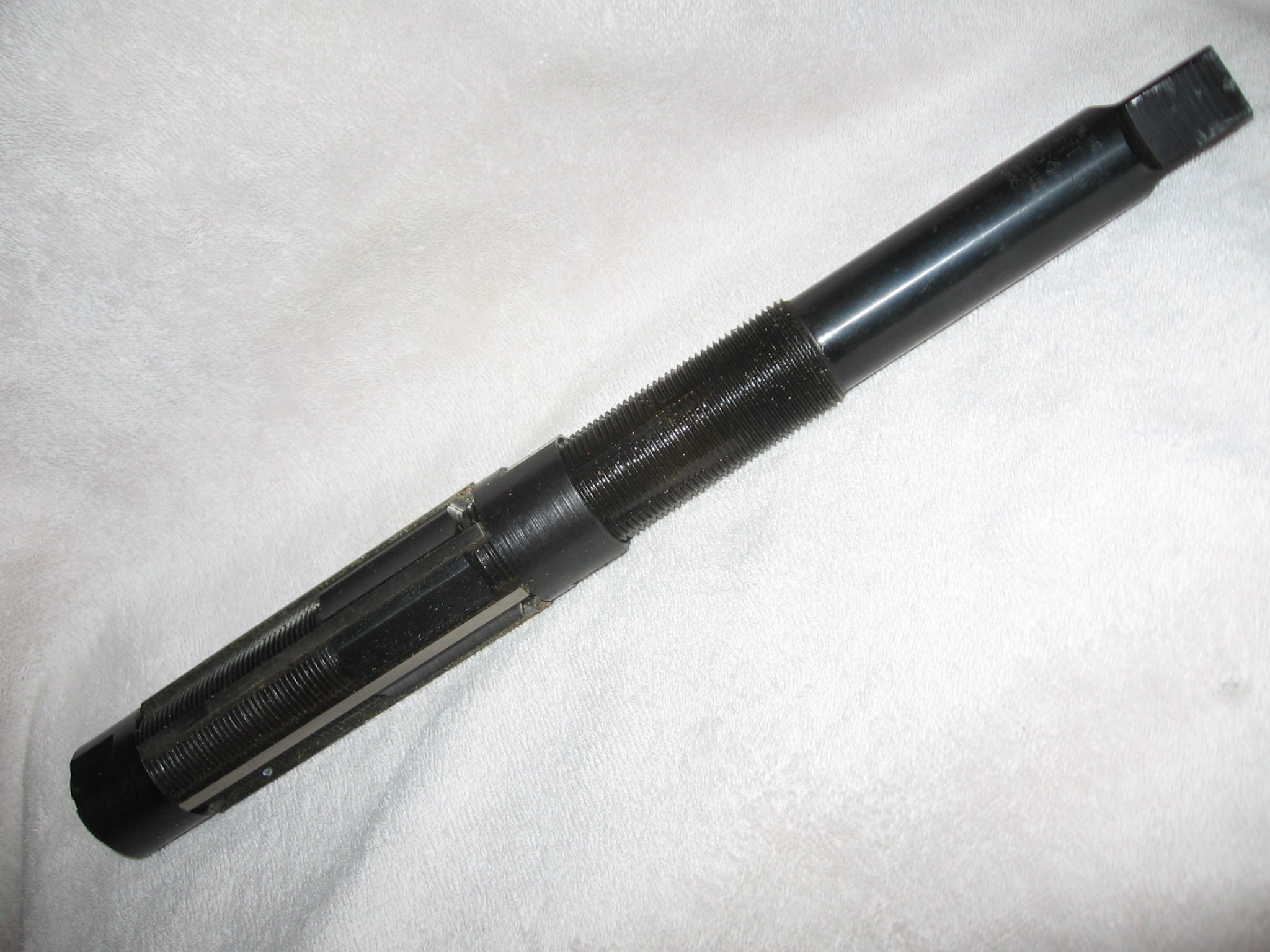

The 3/8"- is 0.147" and the 3/8"+ is 0.162".
Not sure I understand the reasoning behind sizing the drive squares on these adjustable reamers.
I have (3) .250 +/- adjustable reamers, and the drive square on one is .250, one is .218, and the other is a round shank.
One would think a 3/8 reamer would have a bigger shank that a 1/4 reamer. o_O
I normally use tap wrenches to drive these, but on rare occasions I have put them in collets in the mill.

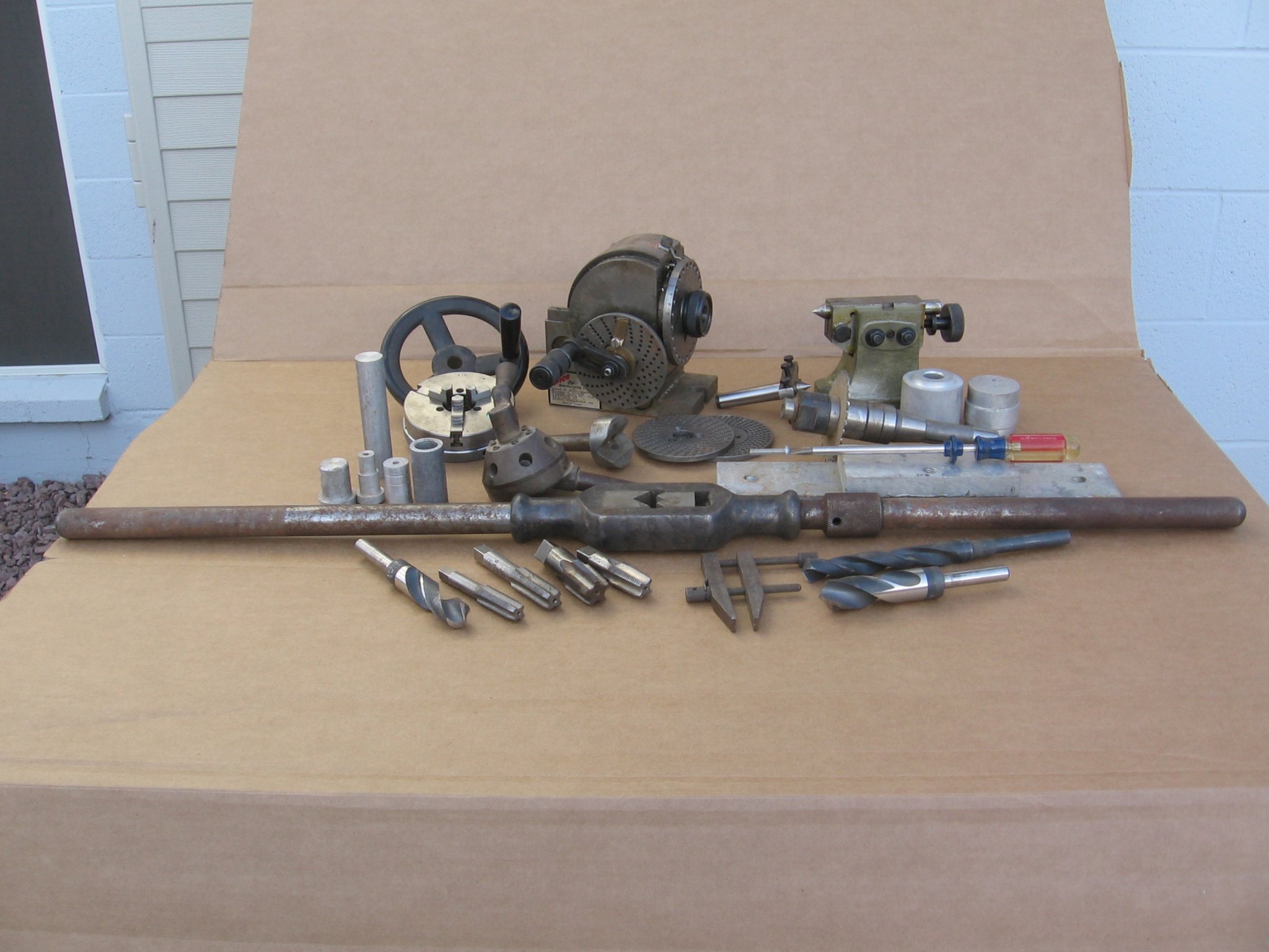

I have a pretty fair range of sizes from 3/16" to this bad boy, 1 1/2" to 1 13/16". Takes a lot of torque to drive this one.

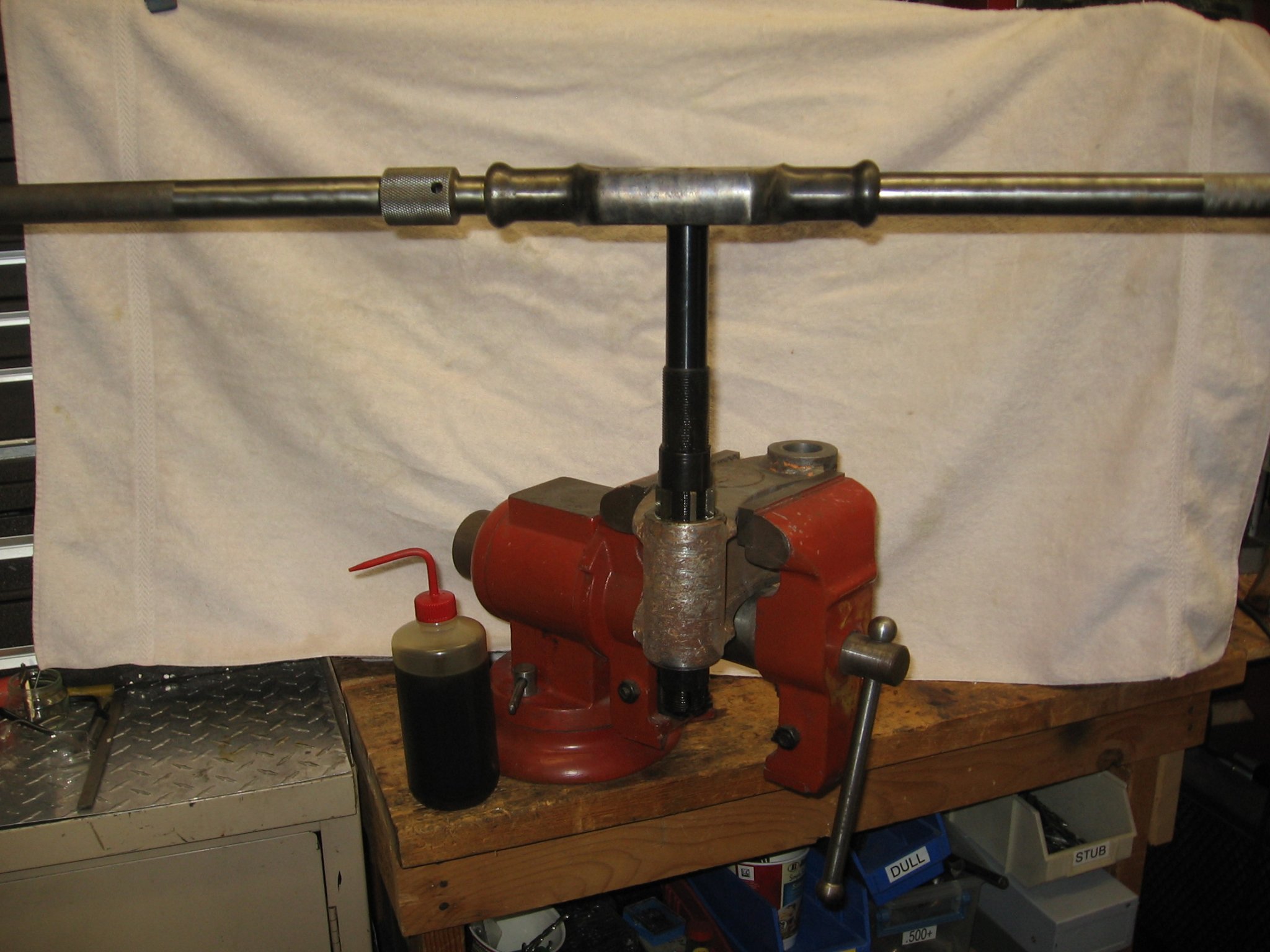

I used the tap wrench below, 41" long.

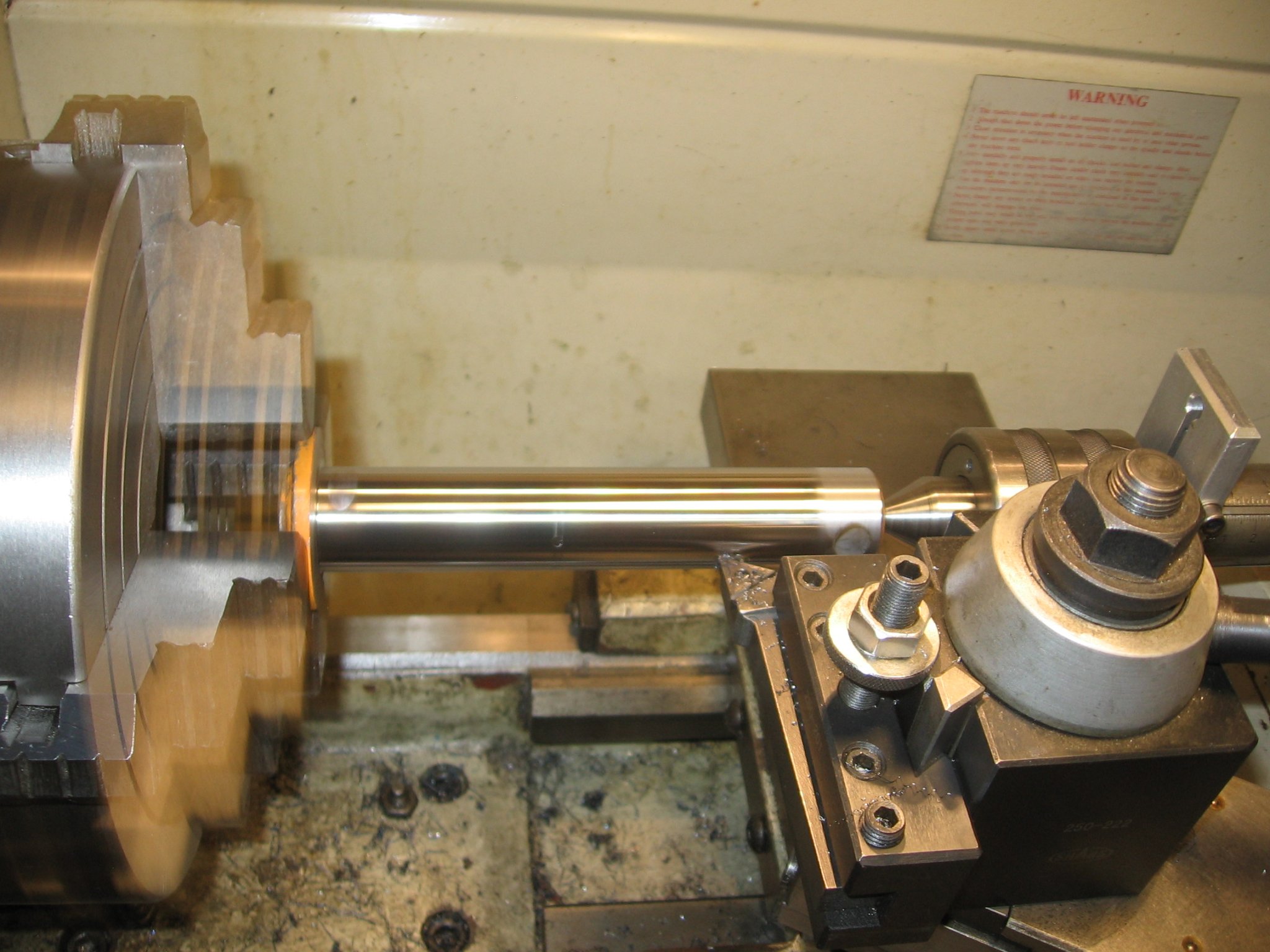

Turned down another pin. (#30 in pic#2)

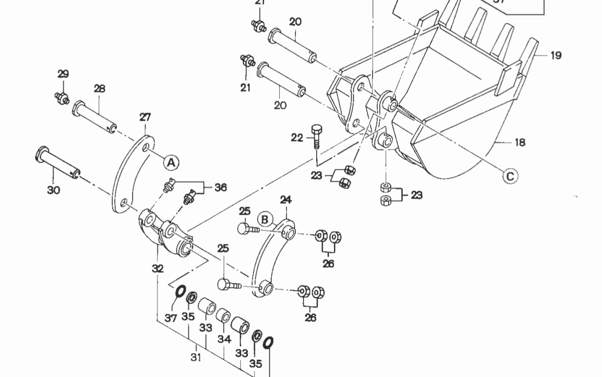

Then I pulled off the Dump Link. (#32 in pic #2)
Soaked it overnight in 50% Purple Power, but still had to scrub it.

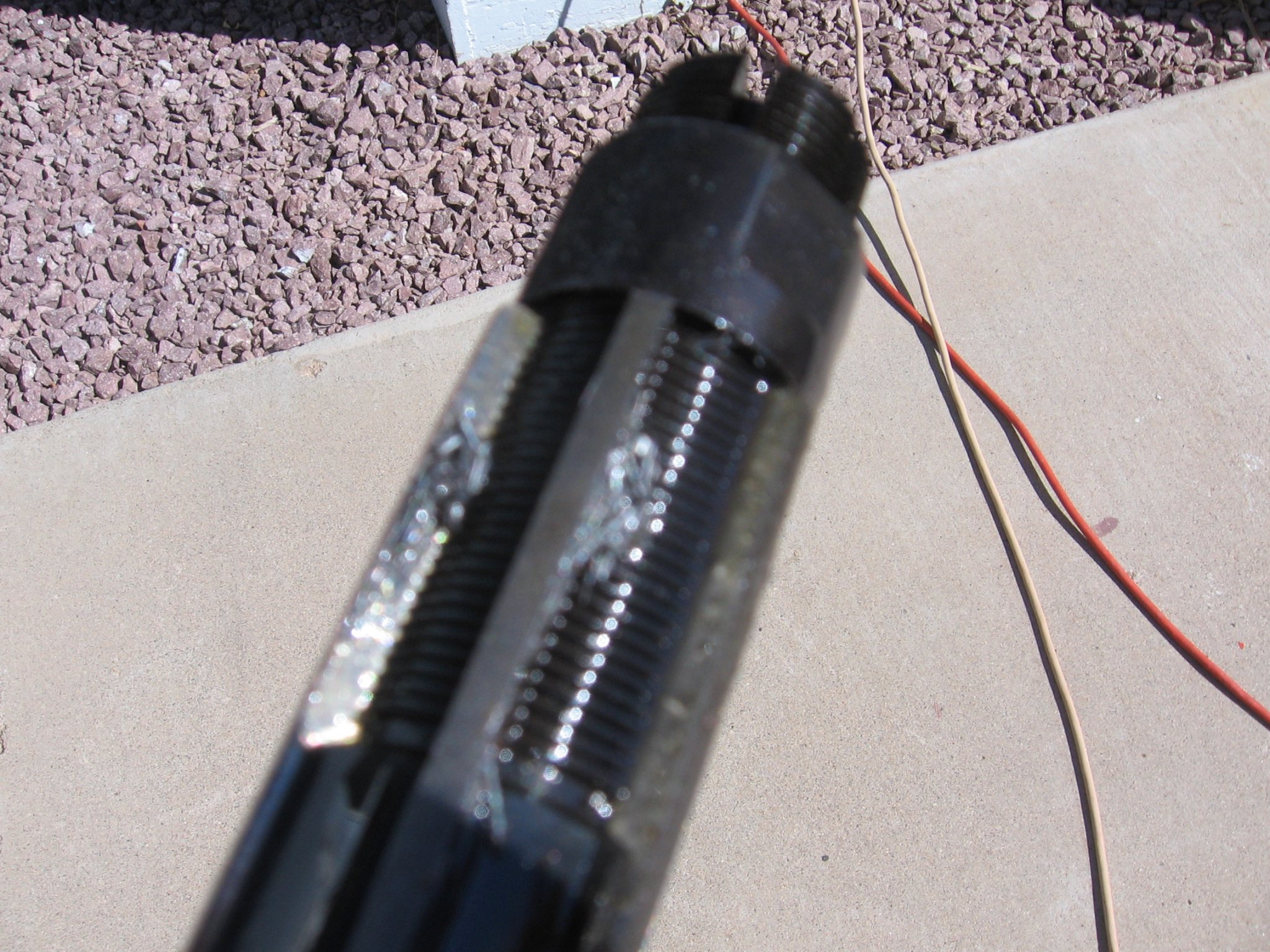

Pulled a broken zerk out, (#36) and pressed out the badly worn bushings. (#33 thru #37) They came out HARD, and galled the bore pretty badly, so I reamed the bore (in stages) to clean up, with an adjustable reamer and a #8 Greenfield Tap Wrench.

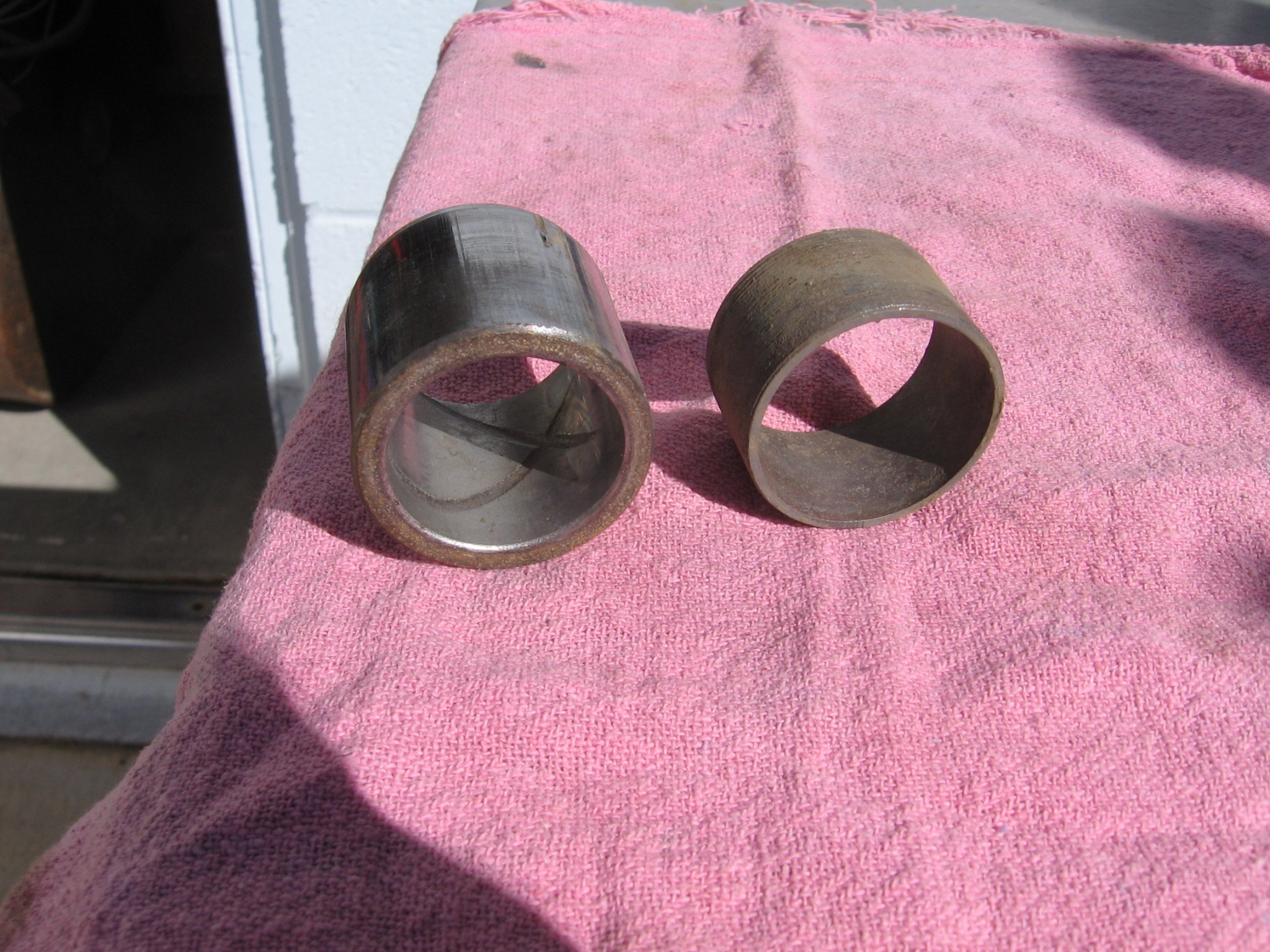

Can you show the parts that came out 33-37? Curious what they look like since i can't discern a reason for there to be so many pieces to it, from the diagram.
I have a couple of broken pallet jack i am going to tear down and try to make fork attachments out of, and i noticed the long pivot shaft in them is 1".. and i need to make several more pins for the B670 I'm still fixing up (i.e. constantly trying and failing to get back to working on..) so i considered that lucky.. Nothing like the amount of effort you're having to go through for this!
8,217
3,602
#37 were o-rings (long gone)
#35 were grease seals (discarded)
#34 spacer
#33 hardened bushings w/grease groove (one discarded)
The plan is to make one long bushing to replace the two plus the spacer. (more bearing surface area to spread the wear)
