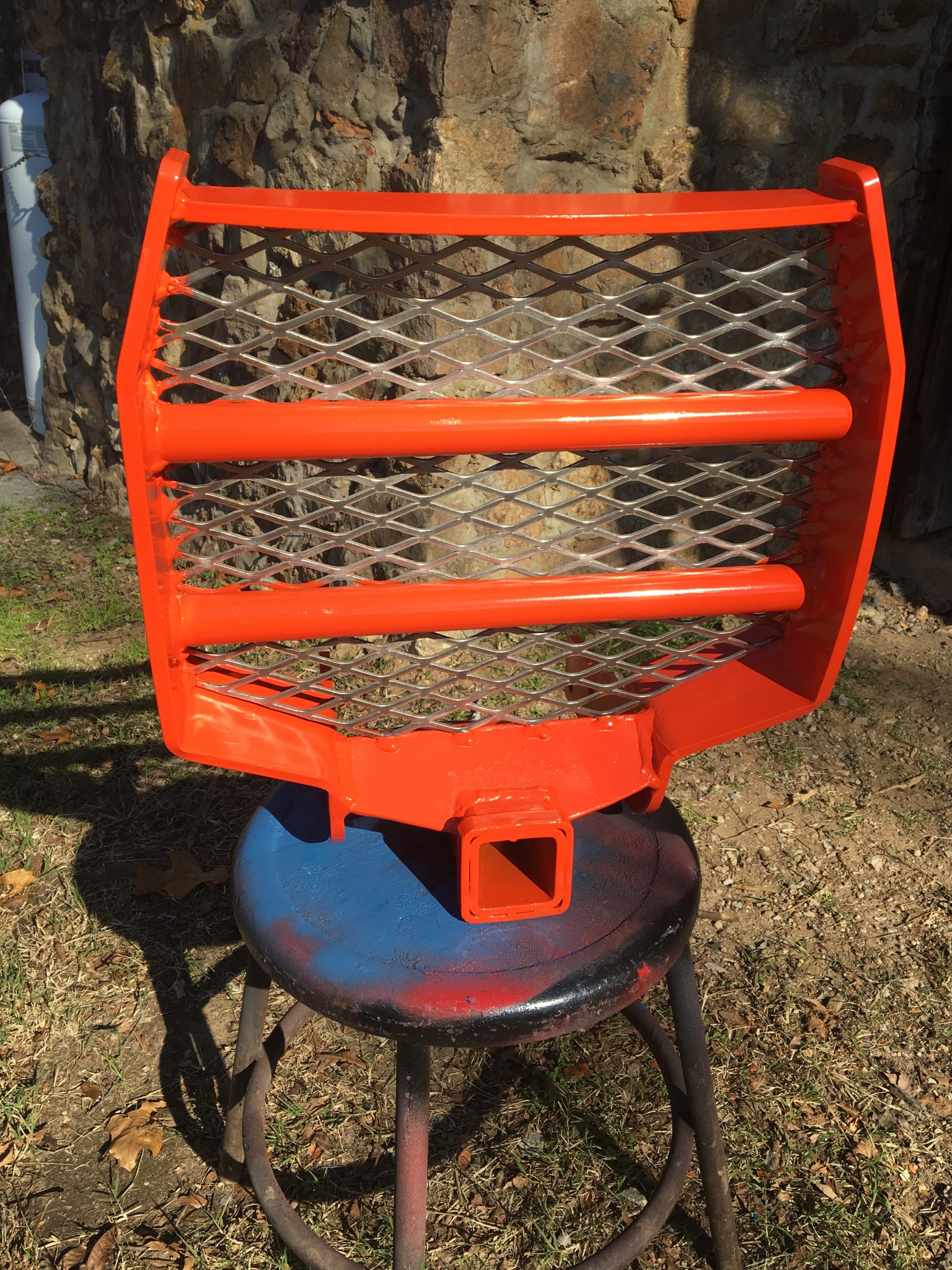

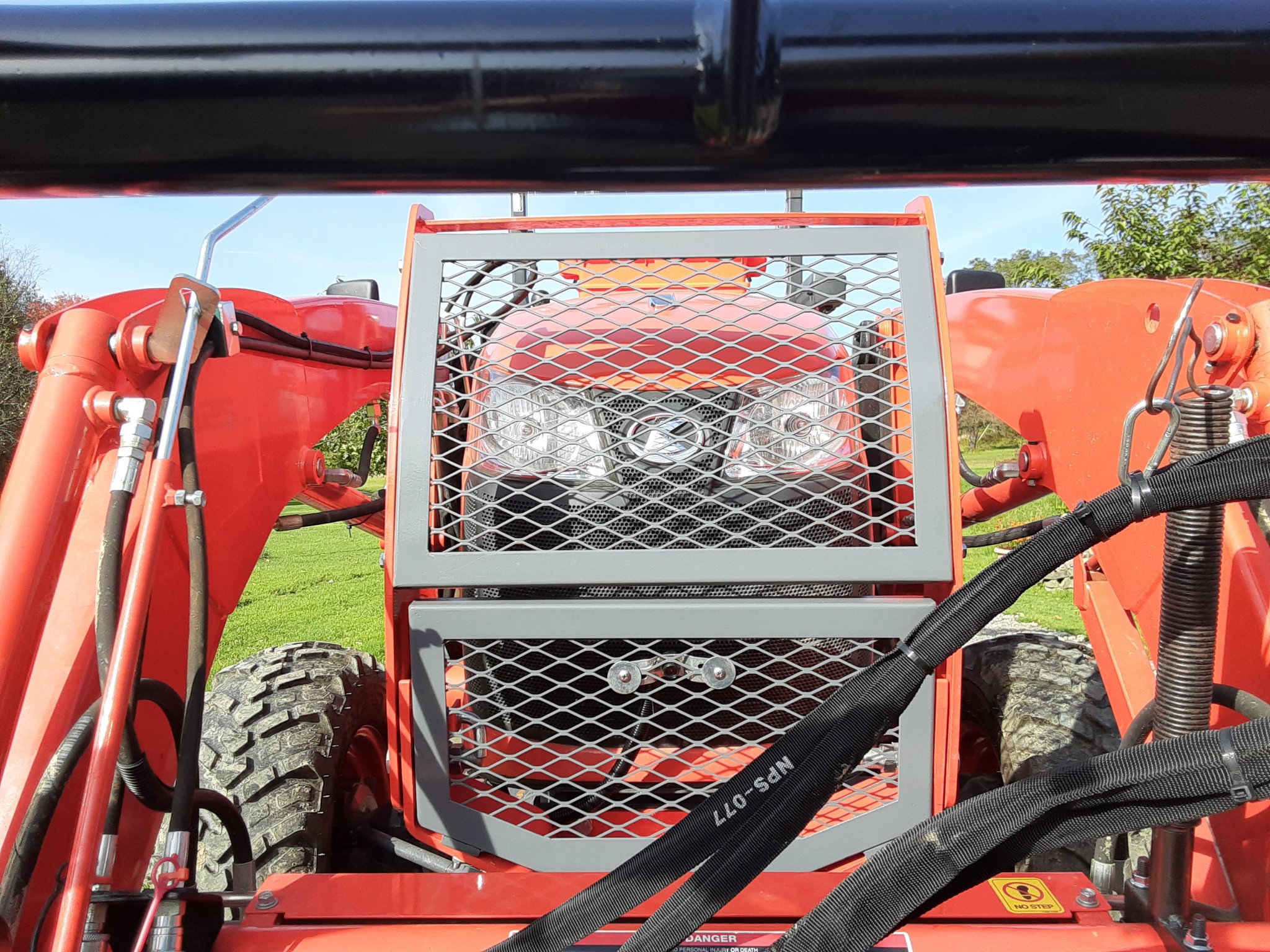

Someone else here suggested expanded metal at Home depot that was between 25-30 dollars for a sheet big enough to do mine. I made a frame out of some bed frame angle and welded to the back of that. Then drilled some holes thru to bolt it to the oem guard. The object in the middle with the bolts is a backup camera that is set up for forward view I am experimenting with for seeing my forks when using them. I can move it around on the grill and found higher works better so far.

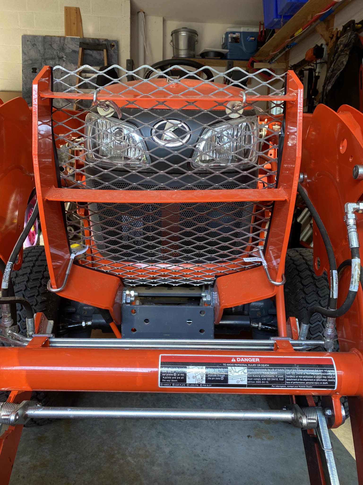

Quarry screen is 1/4” wires is extra tough. Scrapyard find. Good time to add some hooks.
stainless steel expanded metal was also a scrapyard find almost cut to size. <$5. 3x5” angle at bottom blocks stick from coming up.

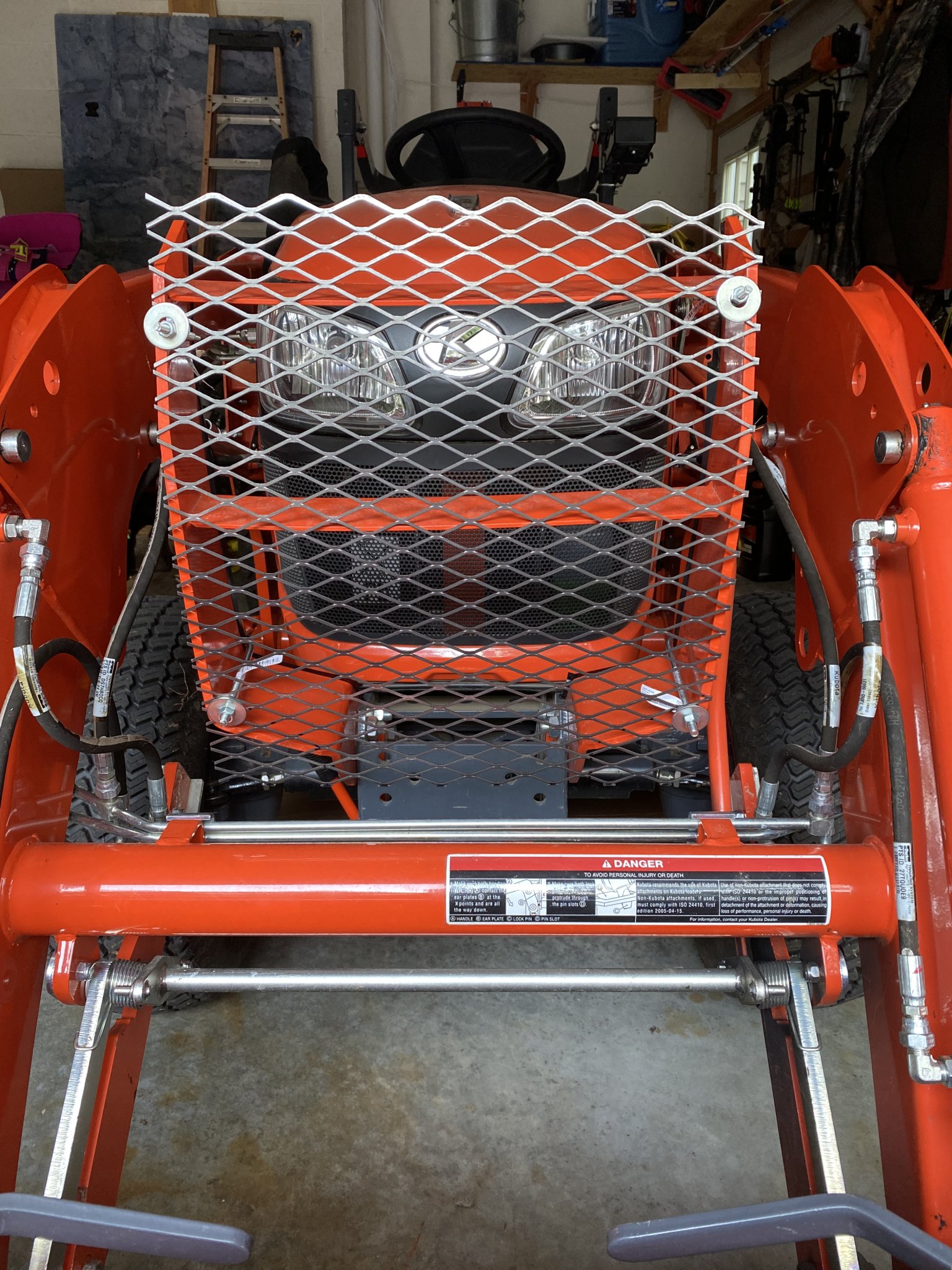

Just some expanded metal attached using some Jbolts. Pic is of the dry fit before I painted it. Don't have a welder but still wanted some protection. F6ABCA41-FA3D-4578-846E-5D451779B38A.jpeg

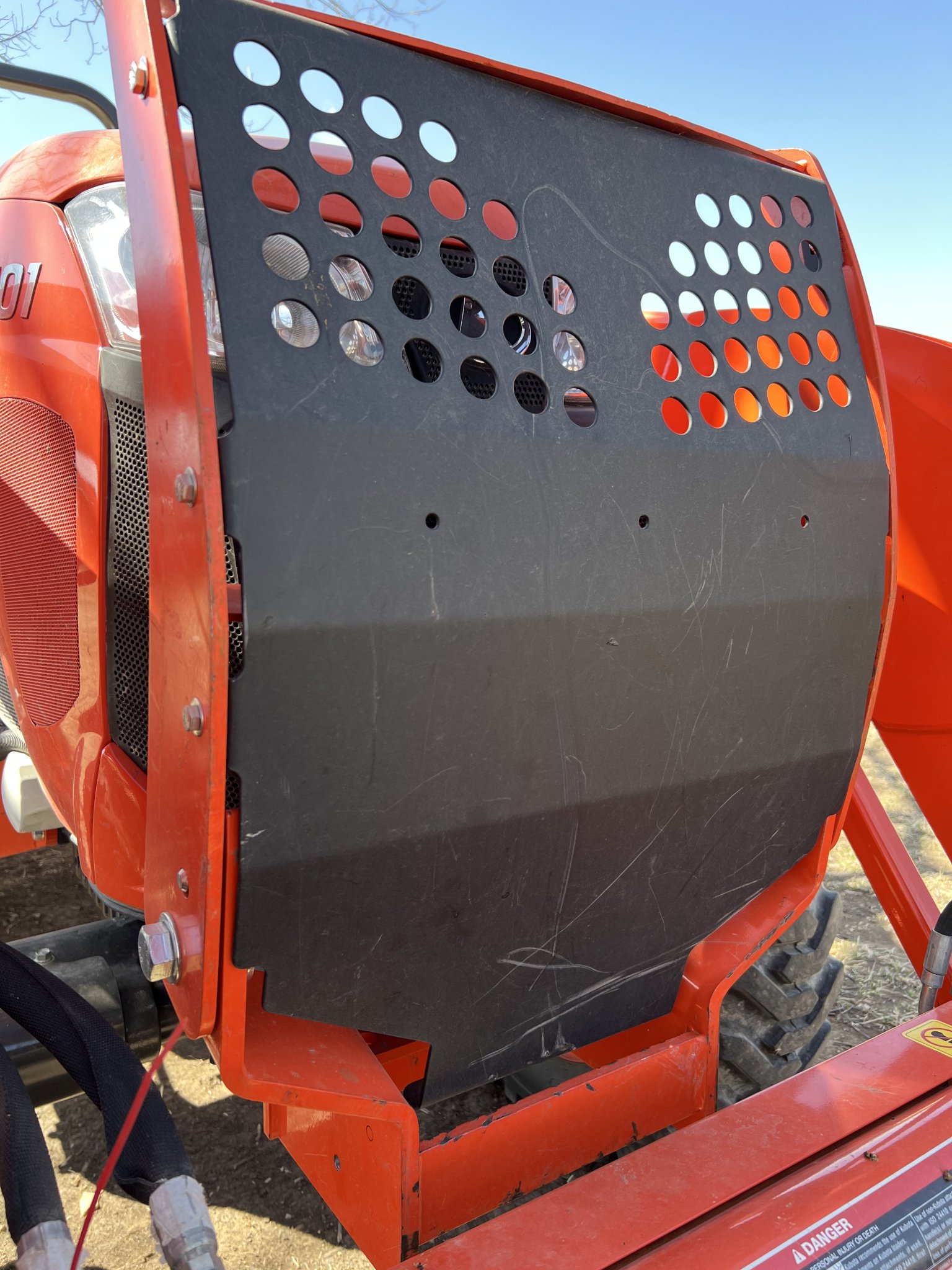

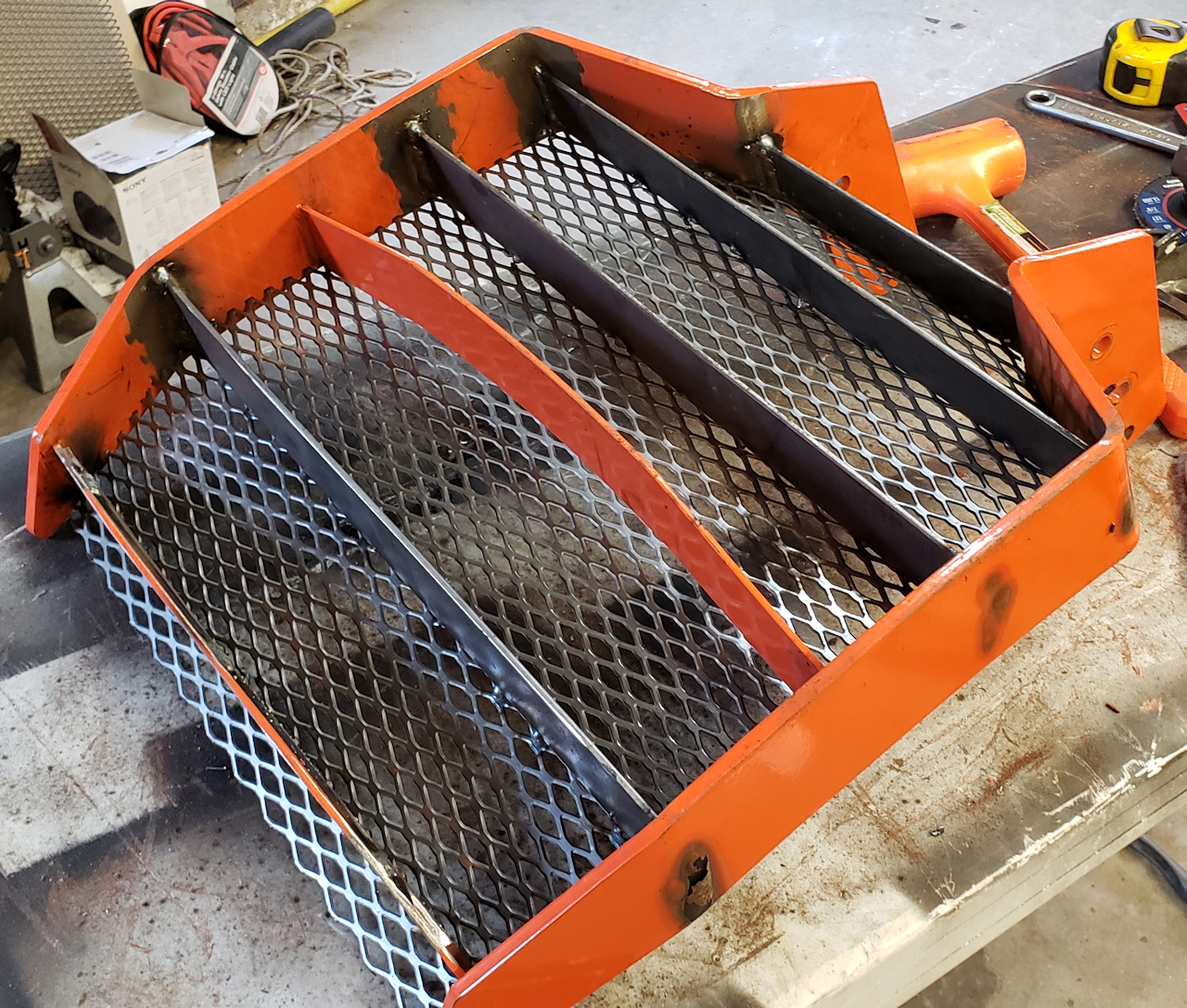

I went a different way, used sheet steel. I wanted max protection on my L4701, for my grapple work. It is showing some wear (did it’s job). I chose to bolt it to the grill guard, so it is removable, if I so choose.

Just some expanded metal attached using some Jbolts. Pic is of the dry fit before I painted it. Don't have a welder but still wanted some protection. View attachment 76425
Why don't you put the expanded metal on the front of the existing guard? Same bolts and more distance to the hood if a small stick gets through!
I placed it on the front as well to see which way it fit better. When on the front it left a lot of the sharp edges exposed and didn't look like it fit as well as when it was on the back. I really like Trapper Bob's set up. I also like these fasteners. Does anyone know what type they are? I haven't been able to find them.

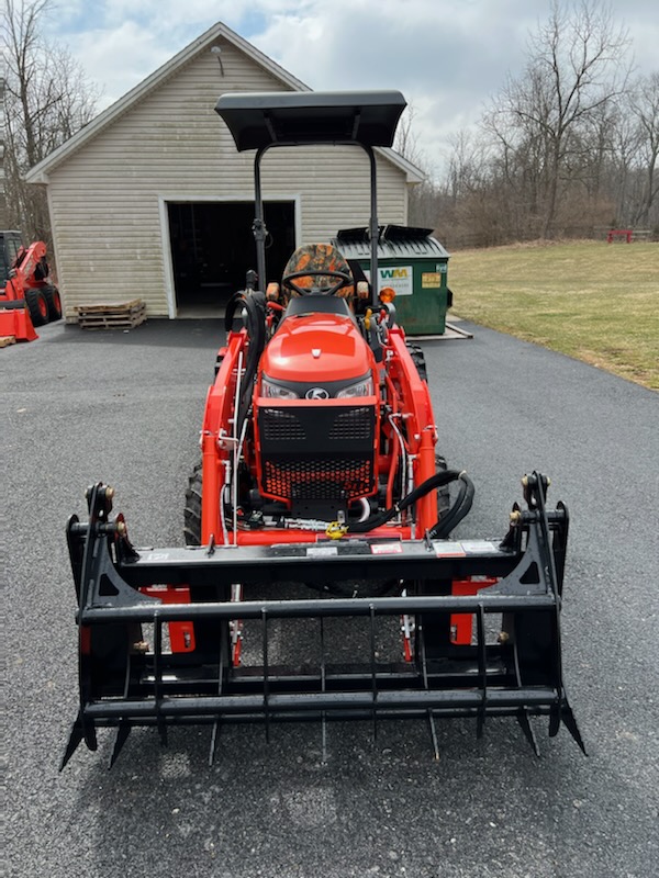

I used a "511 Design" guard on this little guy and love it. It fit perfectly and is well made. 9116E93A-D828-41B5-8D18-CAC901E58C3F.jpeg

Since headlights don’t shine just straight ahead, the large portions that are not perforated block a lot of light. I have the same grille and grapple as you.

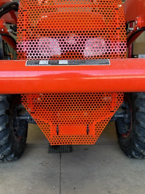

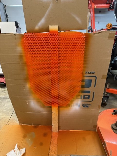

Glad I found this thread. Had been thinking about it after finding a branch that went through the grapple and passed just under anything vulnerable without me having any idea it was there until I got off the machine.
Priced the ready made ones - Ouch!

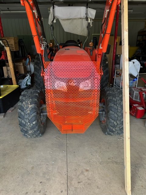

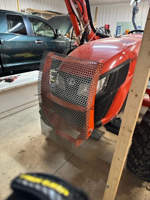

Ended up ordering 18G perforated carbon steel (24x36") = $75 with tax and shipping. Krylon New Kubota Orange (2) @ $12 on Amazon. 1 can spray primer ($7) and 10 heavy duty zip ties ($3). I don't know how to weld and don't have a welder but the zip ties look like they'll hold up OK - time will tell.
I was a little worried about being able to move the guard forward for opening the hood, but the sheet is flexible enough to bend without distorting.
My "paint booth" could have used some sides and a top!
Aren't you concerned about air flow (lack of) over the radiator fins?
There's a good deal of space between the guard and hood. I'll keep an eye on the temp and adjust as (and if) needed. It runs fairly cool at all times so far.
