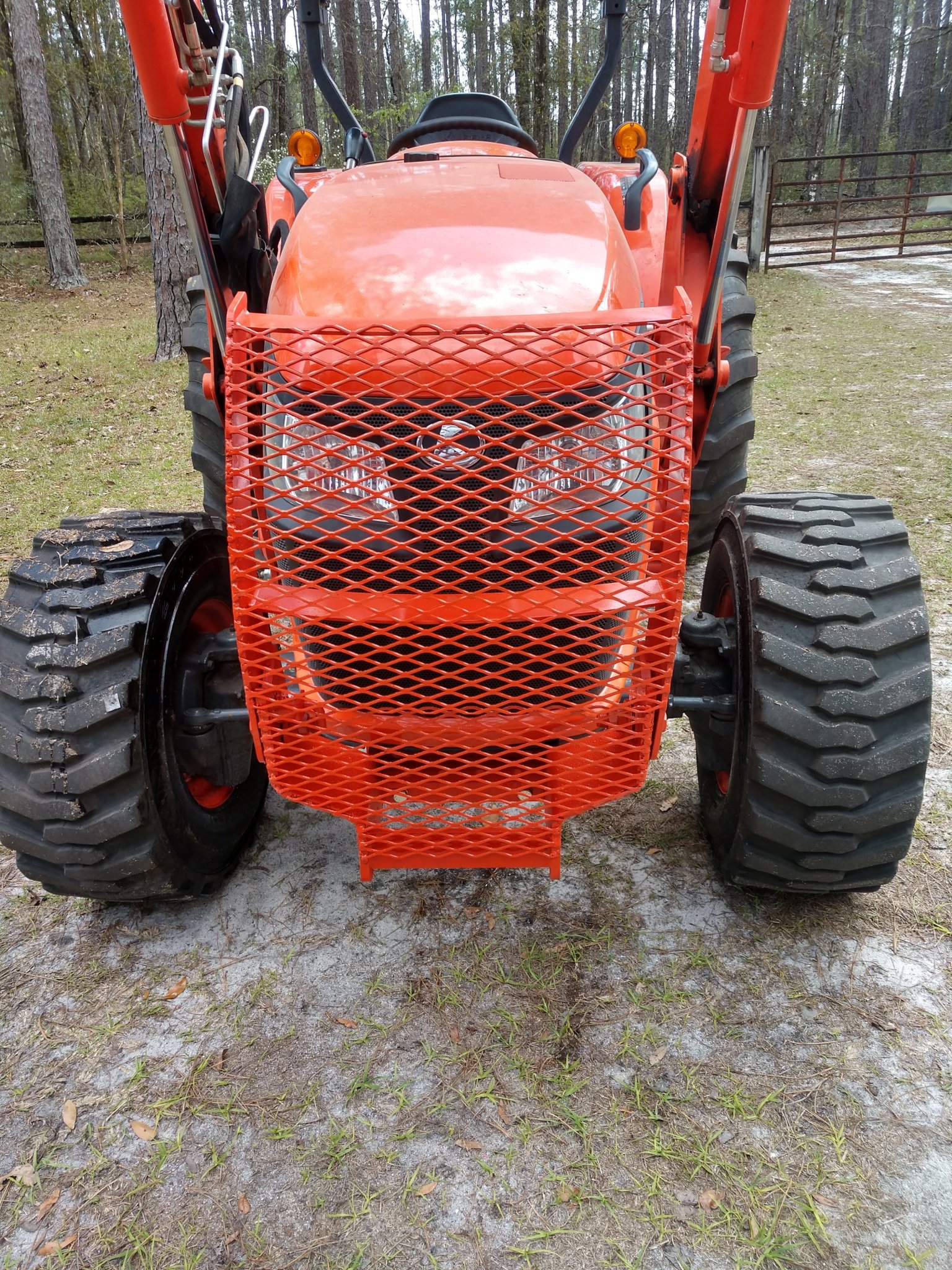

Can you weld? If so expanded metal is cheap and works pretty good. The guy at the metal shop gave me the metal from his scrap pile for mine. I'm also planning on adding barrier to the back of my grapple for added protection. I had a limb come through the back and lift my ssqh lever once.

I used expanded metal on mine. I would like one of the nicer ones and several i have looked like appear to offer better protection, yet so far, this one has worked great and the price was right (cost of the expanded metal which was pre-covid).

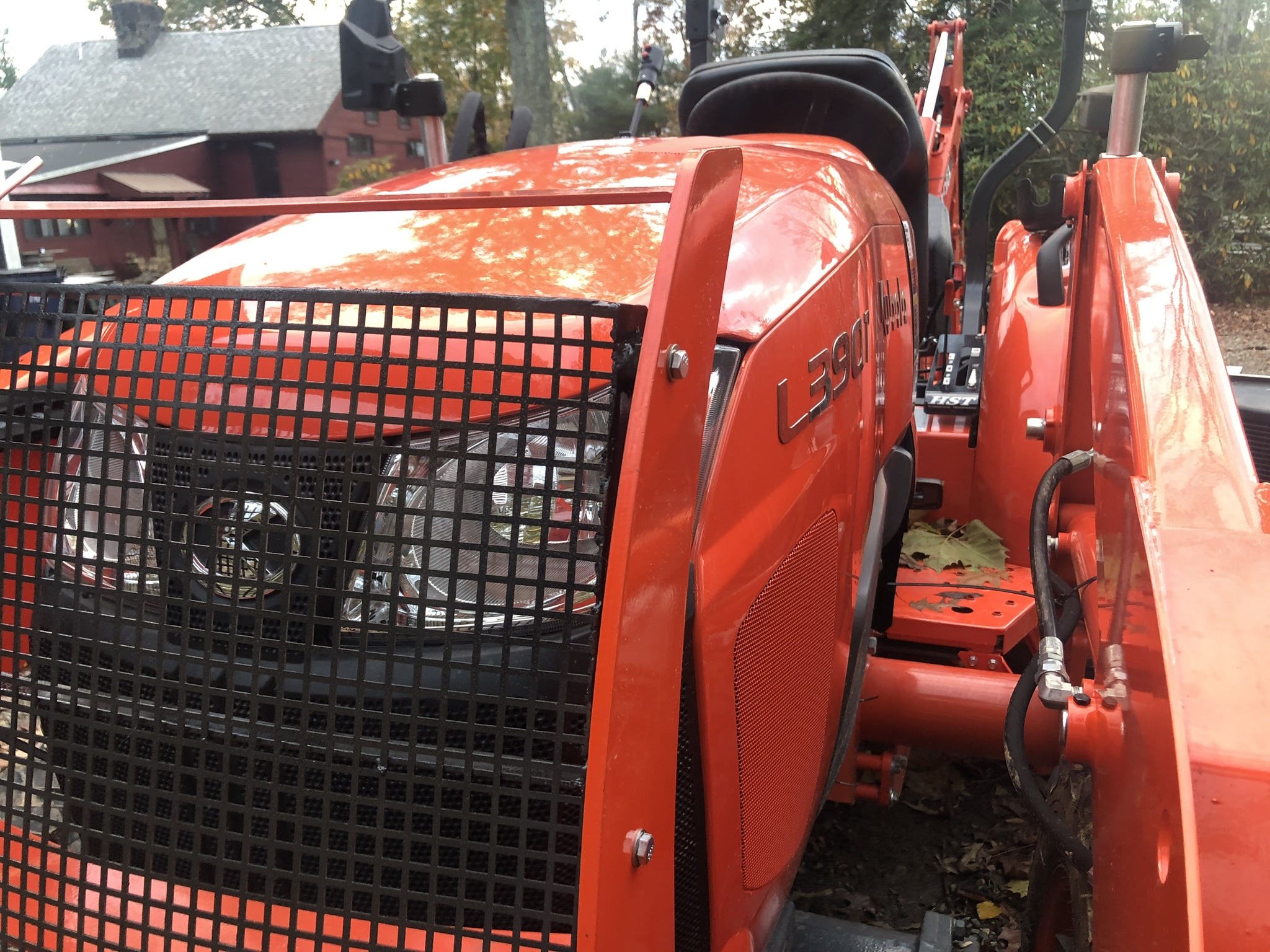

I got some stainless perforated sheet and some stainless bar and welded something up over the weekend. Seems like it will do the job. I liked that it was mostly open so it doesn't interfere with the lights. And stainless so I am not dealing with a lot of rusting down the road. f3741cdb-35c7-4548-884b-741eb29adb27.jpg

I went with the perforated sheet as well.
