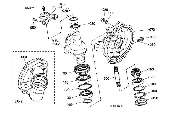

Is this it?
Yes, that is the zerk I am referring to.
I just went over the manual again but it contradicts itself. In the maintenance schedule section there's a lubricants/grease table which says to apply grease to the gear case support until it overflows. But in the diagram showing the zerk location it states to apply a small amount, whatever that means.

Might have popped the seal (#30) like NIW suggests. Can you see it popped out. Looks easy to remove, clean and replace, just a two bolts and a bushing with a seal.
I have been known to put seals in no pressure spots like that in backwards so grease can escape and dirt is still kept out.
GD
#30 does look like a rubber seal of sorts but I didn't see anything like that coming out, just some grease. I'm starting to think (hope) that it's meant to pump old grease out through the seal with enough pressure then spring back to keep dirt out.
What is says SPECIFICALLY AT THE ILLUSTRATION of the 4-wh. drive forward support is to REMOVE THE PLUG and apply until grease flows out of the plug.
