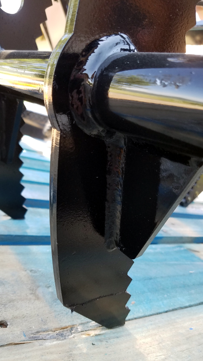

FWIW, choose the design you like best for your application, but do not mistakenly believe some features have some substantial impact on performance.
For example - gusseting, it may not make any real difference in strength. If a grapple tine is 4 inches long and the gusset is 1/4 inch, the tine is now about 7% more resistant to deflection at the tip. Is 7% meaningful? Additionally due to the extra welding of the gusset, the tine's metal may have been weakened and/or made more brittle.
For example - serrations/teeth, there are advantages and disadvantages. My grapple is smooth, and in three years I have never had an issue with securely gripping material - compression does nearly all of the work. Serrations might offer some minor improvement in grip, but they also present some problems. Serrated jaws can make releasing material more difficult as small branches, vines and other such things can get caught in the serrations. Picking up large rocks can also be more difficult with serrations as the rock can bind on the teeth preventing the jaws from fully closing. Many will say serrations (really just teeth with no sharp edge in between like a knife) help with cutting roots. Do they and by how much? Roots tend to be snapped/torn by grapples by pressure - not cut by a sharp edge. The roots I have ripped out tend to snap or pull from the soil well clear of the actual point of contact with the grapple.
You would be correct if deflection at the end of a cantilever beam as a function of load and length is a linear relationship, but it's not. In deflection calculations the length of the beam (or tooth) has an exponent or more specifically is raised to the third power, so a 7% reduction in length results in significantly more than a 7% reduction in deflection. This all assumes small elastic deflections, but in your 4" tine example, reducing the length by 1/4" would reduce deflection by close to 18%.
Even if you are correct (the calculator site I used did show 7%), 18% potentially reduced by the additional welding (real life production welding by humans) makes the improvement small or speculative.
Here are the upper tines on my grapple. A lot more than 1/4" of gusseting with little chance of bending or breaking tines.
But I don't disagree that implement manufacturers add features that have no functional benefit but are included to make something look more capable.

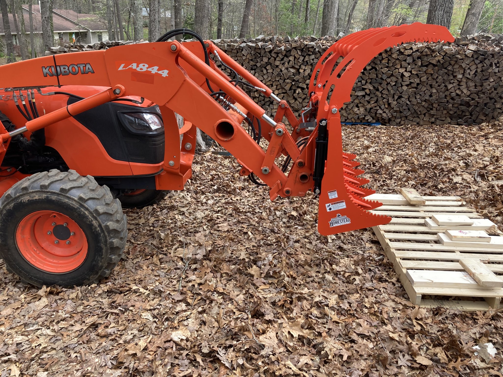

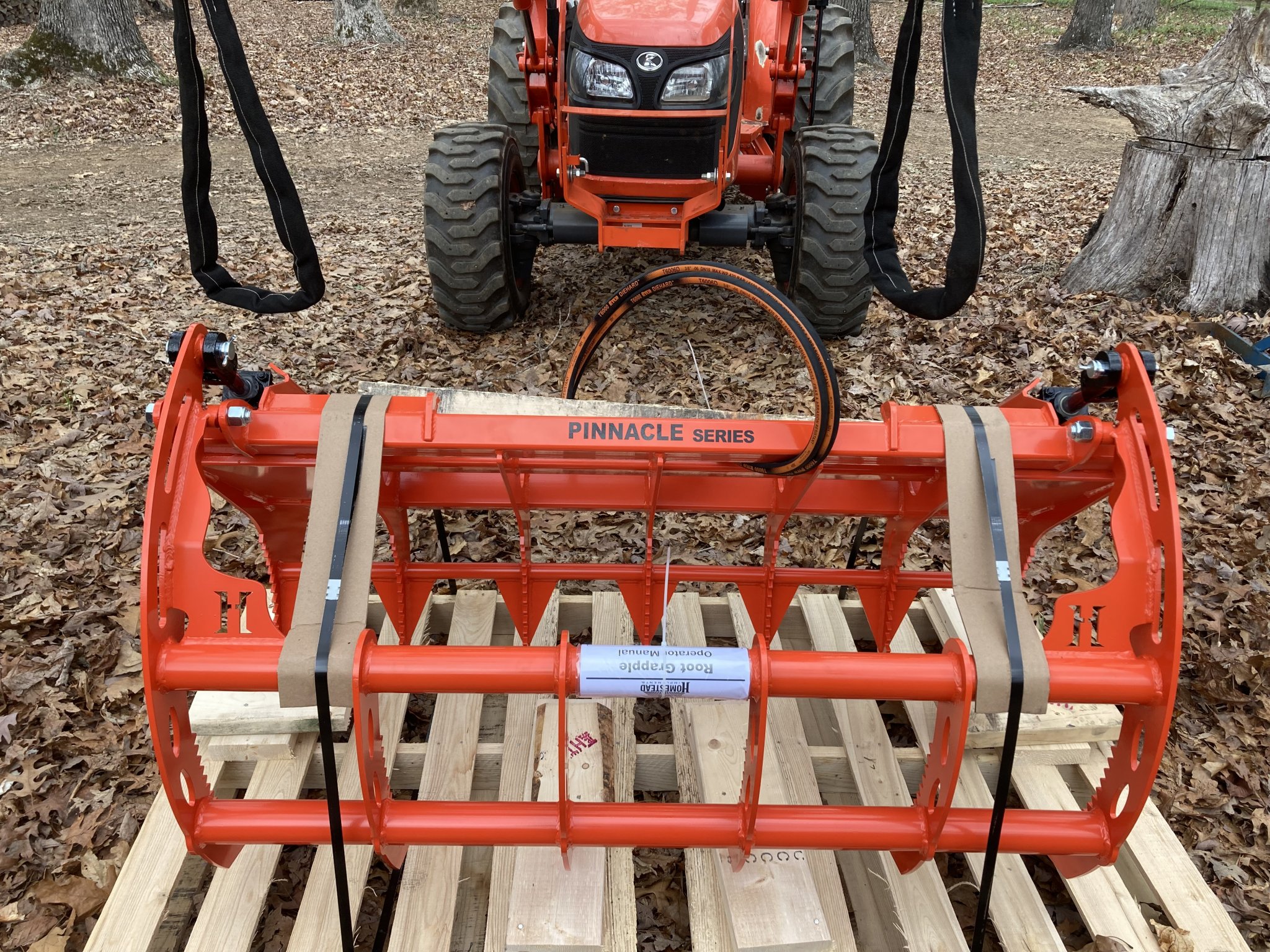

Delivered on 4/1. Everything looks and operates as it should. I’d order from them again. I didn’t order lift gate service but that’s how it was delivered. I stuck my forks into the truck and he wasn’t having it.
