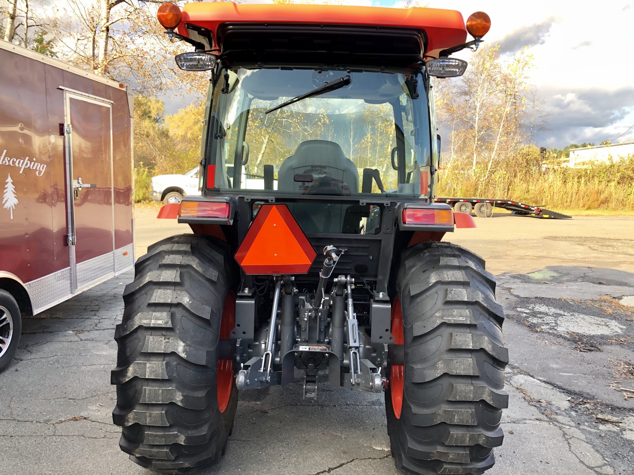

Yesterday afternoon I delivered my 2018 MX4800 HST and 2019 L2501 HST tractors to the dealer in trade for a new L4060HSTC. I was sad to see both my "old" tractors go, as they were excellent machines, but excited for the new tractor.
Here are my initial impressions:
Appearance and quality is excellent. Everything on the exterior, besides the grille, is metal. I noticed on my MX4800, the hood and fenders were steel, but the cowl behind the fuel tank and up to the instrument panel was actually made of plastic.

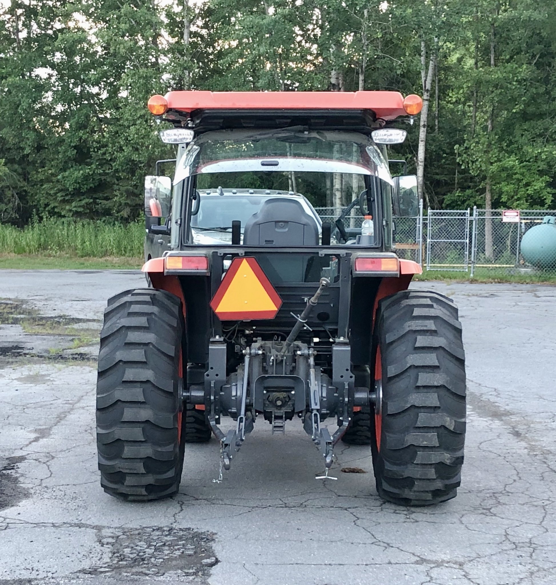

How does it mow? Well, "stock" it is too tippy for my slopes. I came extremely close to rolling the tractor. I stopped and was able to get out, but it was so light if I pushed on the roof area I'm certain I could have sent it down the hill. Fortunately I still had the loaner MX and was able to attach a chain and get the front end headed up hill. Since then, I moved the L4060's multi-position rims out to their max position and also installed 2" Bro-Tek aluminum spacers. I'm yet to get it back to the slopes (raining here finally) but I'm confident it will make a lot of difference. See the stock width and new width with rims moved and spacers on I attached.
I'm mowing with a Woodmax FM-78 flail mower, triple slicer knives instead of hammers, and a trash door than can be opened up in the back. I have the door opened to position 1, which is a larger opening than closed, but still deflects debris downwards. Being honest, the 4060 could use a bit more power. I operate on full throttle, Low range, turtle mode on H-DS. On flat / thinner grass sections I can bump up to rabbit mode. However, the mower goes through thick 4' tall grass perfectly well so long as you don't mind going slow. Stall Guard, which initially seemed useless, actually is awesome. It's a little abrupt, but it won't let you really ever bog the tractor down. The factory cruise control is amazing...just like a car, even with bump up/down. Combined with Stall Guard, you can just set a speed and do nothing other than steer.
The cab is really nice - the A/C works very well even in 90-degree weather and tough humidity. You see huge amounts of dust and chaff blowing around, but you aren't inhaling it. You see the bugs and bees landing on the windshield instead of you. You aren't sweaty and covered with dirt at the end of the day. The stereo works pretty well and its nice not having to wear ear protection for hours. Your drink in the cupholder does not become super-heated like it does on an open station machine.
Downsides? Yes, a couple. The swirling dust and dirt and chaff sticks to all the glass. Yes, you have a front and rear wiper / washer but you end up using a lot of windshield washer fluid and can only see clearly out of those small wiped areas. You can't see well out the side doors. Also, the seat is not comfortable...primarily because the springs aren't strong enough to support 225lbs or more and you settle to the bottom. I still haven't found a way to fix this problem yet.
I like this machine a lot. An L6060 with the air seat would probably be perfection. Just did the 50 hour engine oil and filter change....straighforward as on all Kubotas except this one has a very cluttered oil fill cap area.

Troverman, I have had my L3560HSTC for 6 years now and agree with most all of your report, nice job. Like you, I found the tipping of the tractor very discomforting as it is so top heavy. I installed 3" BORA wheel spacers on it and it helps a lot, but still very uncomfortably tippy. Then again, I have some VERY steep hills on my property. Enjoy your tractor.

Did you move the rims out to their widest setting? That gained me probably close to 3 inches. That and the fact that because of the slopes I work on, I've probably developed a high tolerance to side angles.
Edit - looks like you have turfs which probably don't have adjustable rims.

Right, no adjustment on rims. The big thing was when I put the spacers on, the tractor wouldn't fit on my trailer any more. Sold the old trailer and had to purchase a new deckover trailer. Always something.
