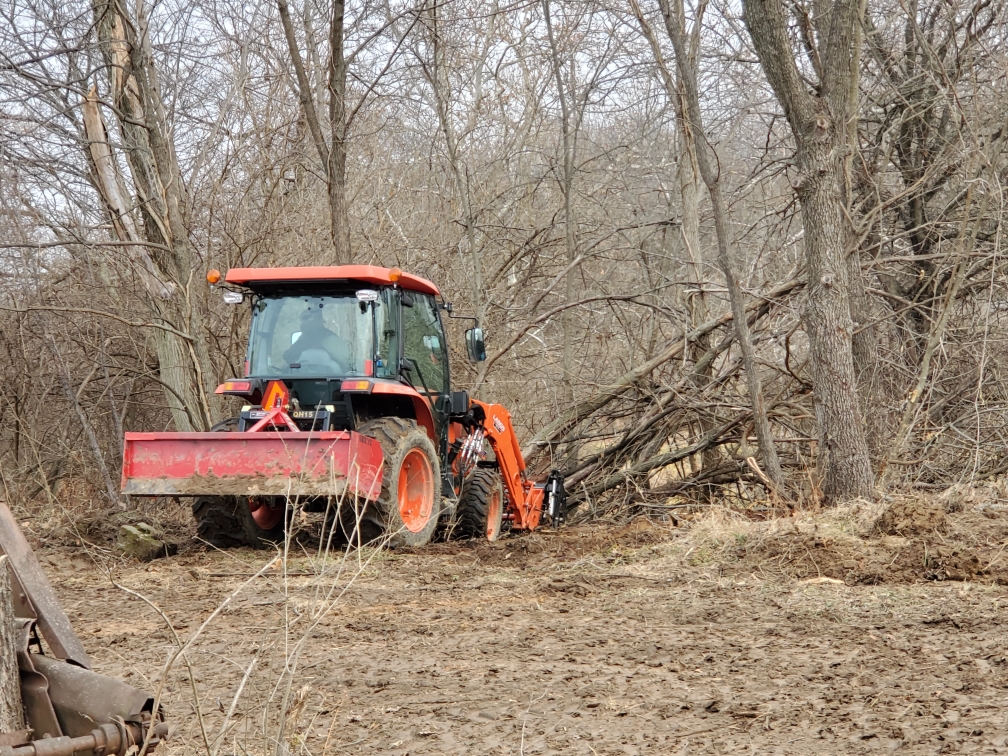

I have the L3560HSTC. I'm not in the hills of Tennessee, but we have some hills on the 80 acre farm. When I first got the tractor I was very nervous about the feel of it on the hills. This coming May will be three years with tractor and I have gotten much more comfortable with the tractor and learn how it feels. I use four wheel drive a lot (almost all the time) because we have very few flat spots.
My tires are loaded and I keep the loader low with the exception of when I'm stopped (got grab the picture) or placing material on the piles. Unfortunately, you can't tell slope on the pictures below, but the second picture is on top of the hill by the barn and then it slopes down to the creek (the brush is all gone now, the third picture). You can see in the fourth picture the level (sorry it is a little blurry). The tractor has handled the hills well. Again, you need to learn your equipment and how it balances and I can't emphasis enough that when you are on the hills, keep the loader low as possible.
So, the tractor has done well for me and I'm glad I have the cab. It is nice to have AC in the summer and the heat in the winter.
