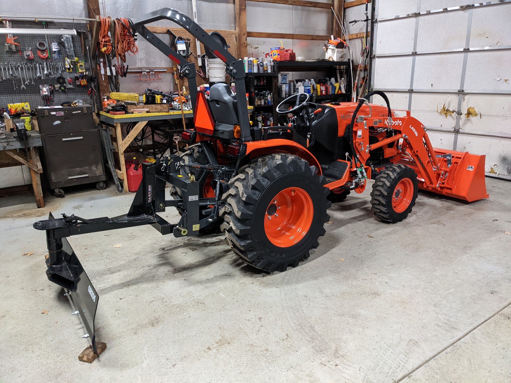

A couple of things that I forgot to mention.... The motor on the 2501 is set back farther from the front of the tractor than the motor in the LX. The only thing with that is if you do your own maintenance you MIGHT find the LX easier to work on. My LX2610HST with 2 rear remotes, 3rd function, loader & 60" bucket and the big 15-19.5 R4's loaded with RimGuard weights 3,555 pounds with a quick hitch and 6' chepo Tarter back blade. That is quite a bit heavier than the weights in the brochure lead me to expect.
Thanks…..What length trailer would I need for 2610? Almost forgot…what is a rear remote and 3rd function?
