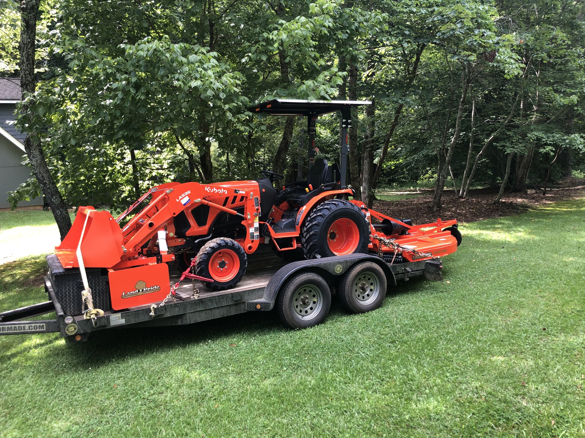

Thanks…..What length trailer would I need for 2610? Almost forgot…what is a rear remote and 3rd function?
16’ sorta fits… but leaves no room for activity’s. And the cutter hangs off about 3’. If the toolbox wasn’t mounted on the deck, it would be much better.

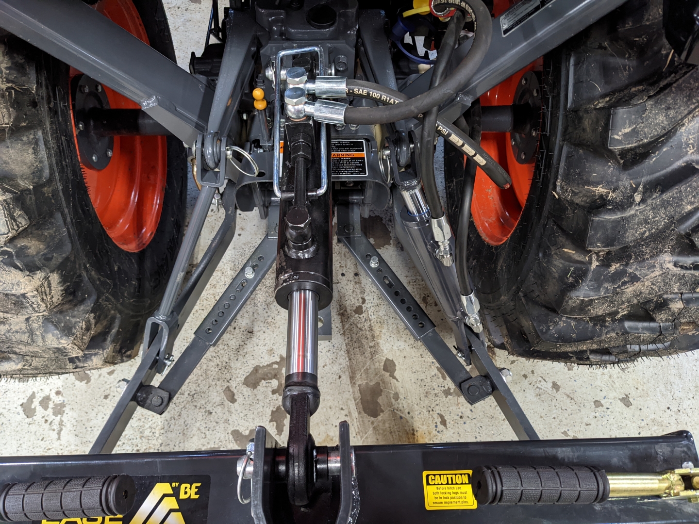

Rear remotes On the LX you can get 2 on the L2501 I THINK you can 3 Cheaper if you get them with the tractor than it is to add them later. HOWEVER they are expensive and you can get aftermarket "kits" from places such as Summit hydraulics for a lot less. The drawback is the aftermarket ones are not as "neat & Tidy" for the placement of the controls as the factory ones. I have the factory spring center for the 1st one and float detent for the 2nd one Again in Sept '21 they cost a total of $1,266.00 for both of them. I use them for a top 'n tilt kit I made for my quick hitch.
Attached is a photo of what a top 'n tilt kit looks like
adding another vote for L series but regardless to get an HST no matter what
20', unless you want it to look like Matts : )
and here is 22'

Lol. Hey now… that 16’ got everything home in one trip!
