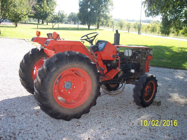

14,636
7,102
White Cloud, are you going to have any critters on your 65 acres?
I have a goose neckstock trailer I used to haul an L3250 360 miles home last weekend.....in my stock trailer! Pulls nice at any speed. Sets low, so easy to load.
If you go with a gooseneck be sure to get something that sets low.
