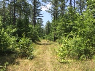

D2Cat,
No critters planned. It is all loblolly pine. Here is a picture.
