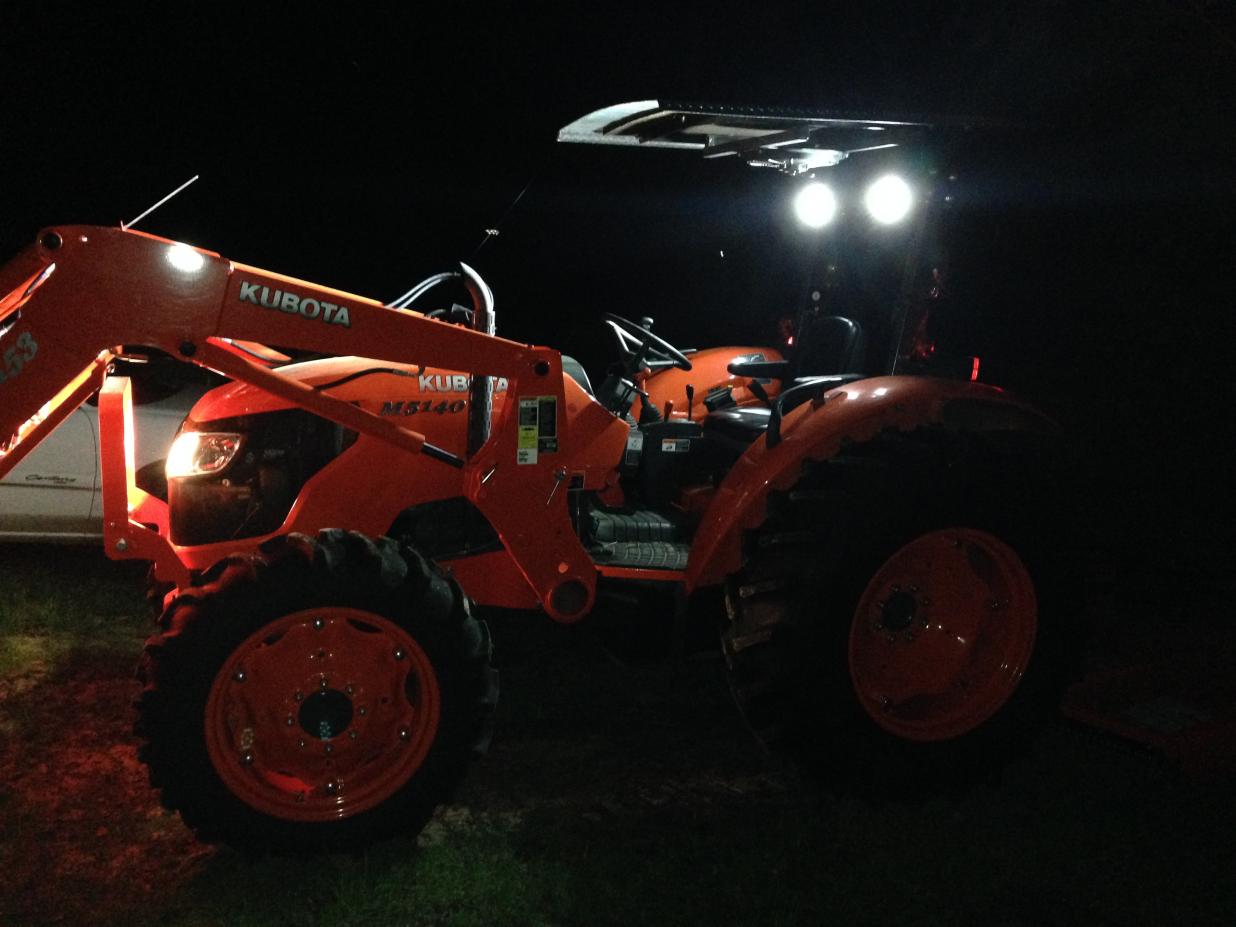

Amen on the ROPS lights. My bucket and grapple nearly totally block the head lamps. I've got two LED's mounted on the inside of the ROPS midway up the side. Would have gotten a back one too, but already had a Kubota light. I'm telling you they light things up!
Got mine from www.ropslights.com They are made specifically for your tractor, have everything you need and install in about 15 minutes. Ordered on Monday got them on Thursday, they come from Canada. They followed up with an email to make sure you are happy. You can piece out a set for less money, but if you don't have the time, want first rate quality and one that's easy to install these guys are hard to beat.
