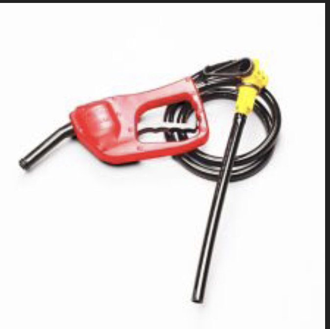

I would use something like this if your just using a fuel can. Couple of pumps and gravity does the rest.

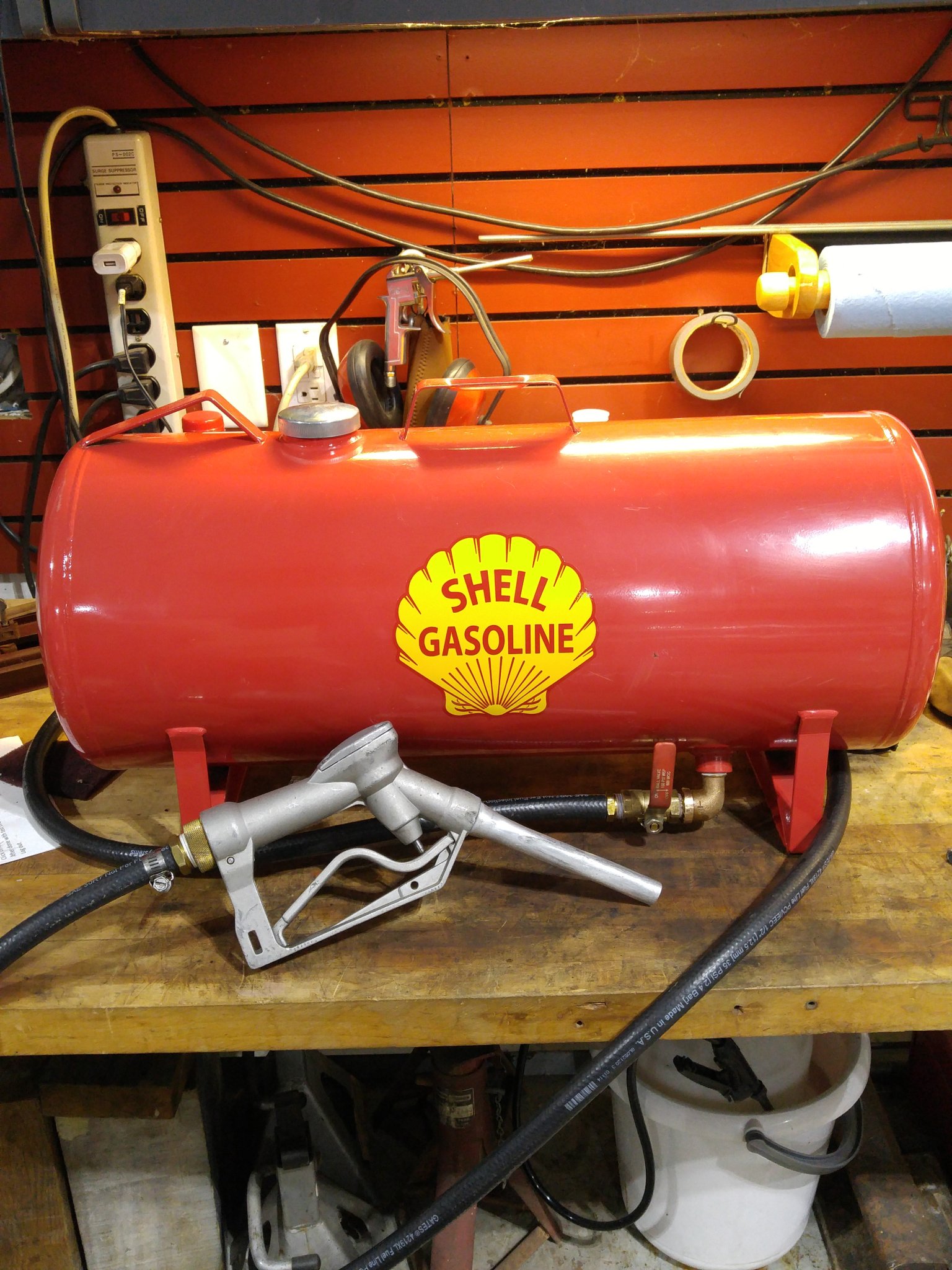

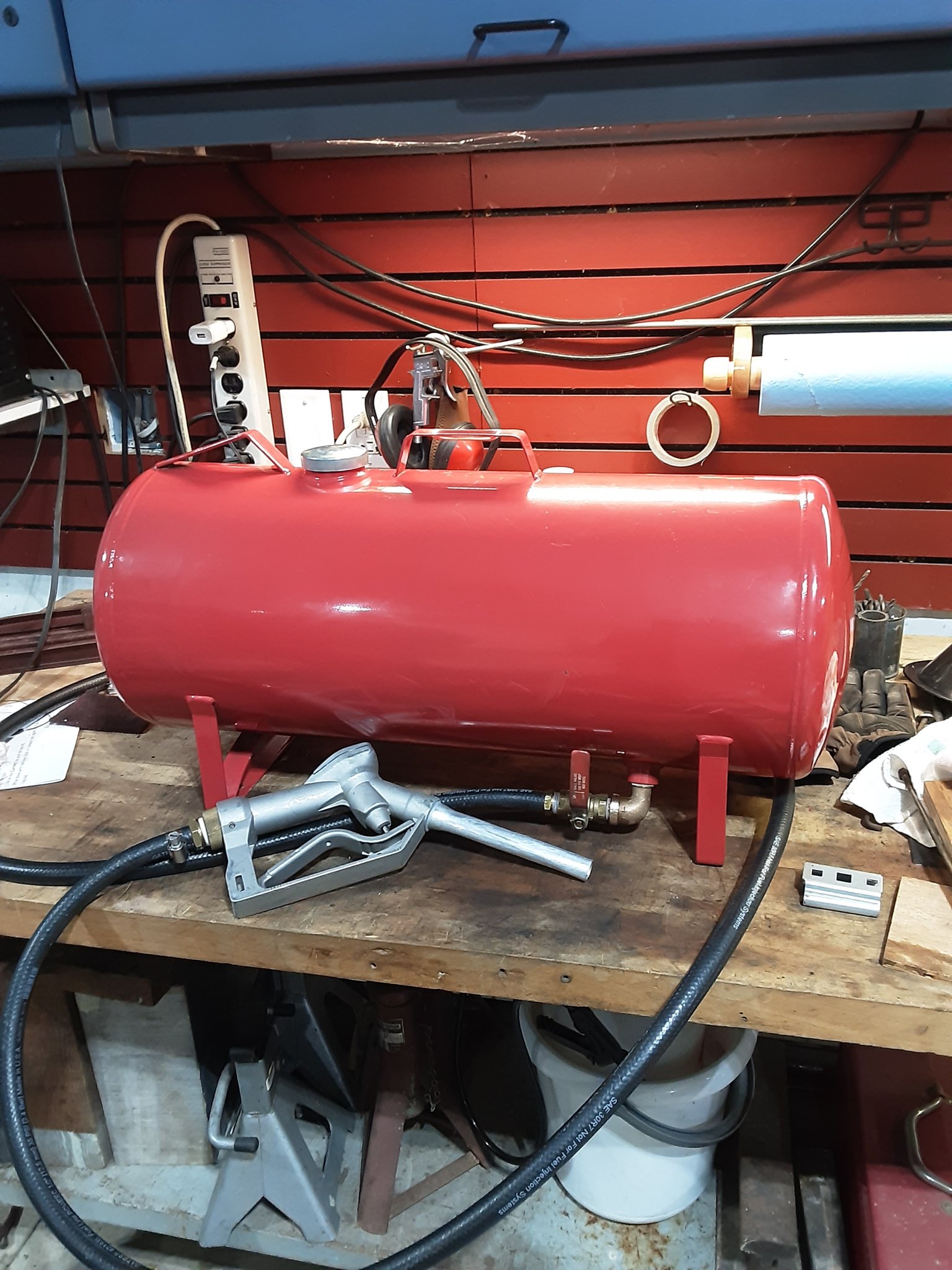

Here is the setup. Paid $35, and was only 15min drive from work. Came with 2.5gl of some nasty old gas. Talk about stink. And its fair share of sludge, varnish and rust. The nozzle had been nearly flattened by being run over. But I knew it was all salvageable.
Dumped in a quart of acetone, some chain, old lug nuts and shovel of 3/4 rock. Got a real workout shaking that around! That got the bulk of the junk out. Then I filled it full with hot water and a heavy concentration of Oxyclean. Let it set for 24hrs. Wow...I was floored how well that cleaned the remaining varnish.
To tackle the rust, I dumped in 2gl of water with heavy concentration of citric acid. Rotated tank in different positions every 12hrs to get all the surfaces. Did final rinse with plain water, followed with 2 rinses with 2 qts of diesel.
Pro-tip....citric acid will eat limestone rocks!
Its 99% spotless inside.
The nozzle is a press fit into the handle body. I removed it and hammered in a pointed round pry bar to reshape things. Slathered on some gasket seal and pressed back in. Still has slight curve to the left, but it works.
Shell Gasoline decals on order.
A fun little project for the weeknights. Keeps me off the streets.

How many gallons does it hold? If you're looking for a new nozzle might check with where ever you purchase fuel. When their nozzles automatic shut off quits working they just install a new nozzle. I got two of them last time I asked!
It is 10gl. Think my repair of nozzle will do the trick. Funny you mention the auto shut off...mine on the diesel tank is acting up. I need to look at it to see if repairable.
