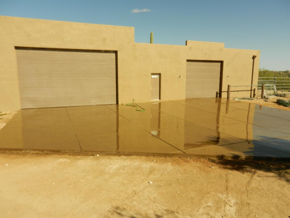

That's a good point: Think about what type door you will install.
I have two 12 x 12 chain-motor roll-up doors that work reliably and easily in one side of my barn. In the workshop side, I have two 20' x 12' commercial sectional panel roller doors. They are heinously expensive to get worked on and require huge commercial door openers. I recently had a commercial door company come out to fix a problem and it was $600 without touching the springs. That would have added another $500. I priced the farm-style chain-motor doors and a 12 x 12 runs about $1000 uninstalled.
Aircraft hangars use a bi-fold door that usually only has two hinged panels and come with opener motors. They are cheaper that roll-up doors and offer shade outside the opening. If and when I have any more problems with my commercial doors, I plan to replace them with bi-fold doors.
The commercial door is on the left, the farm roll-up to the right...
