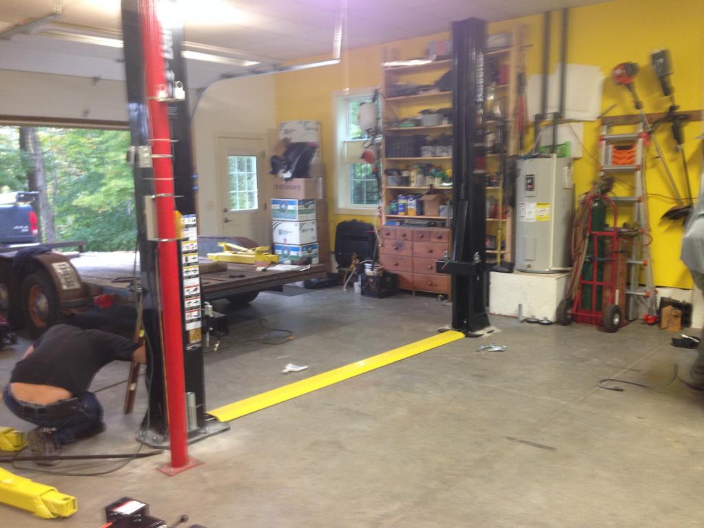

Watch your height, you might want to put in a lift if you do a lot of diy. I built my house on 12 foot basement, my garage in the basement is 32x30 wish I had more. put in a dannmar 9000 lift and wish I had 14foot ceiling.
