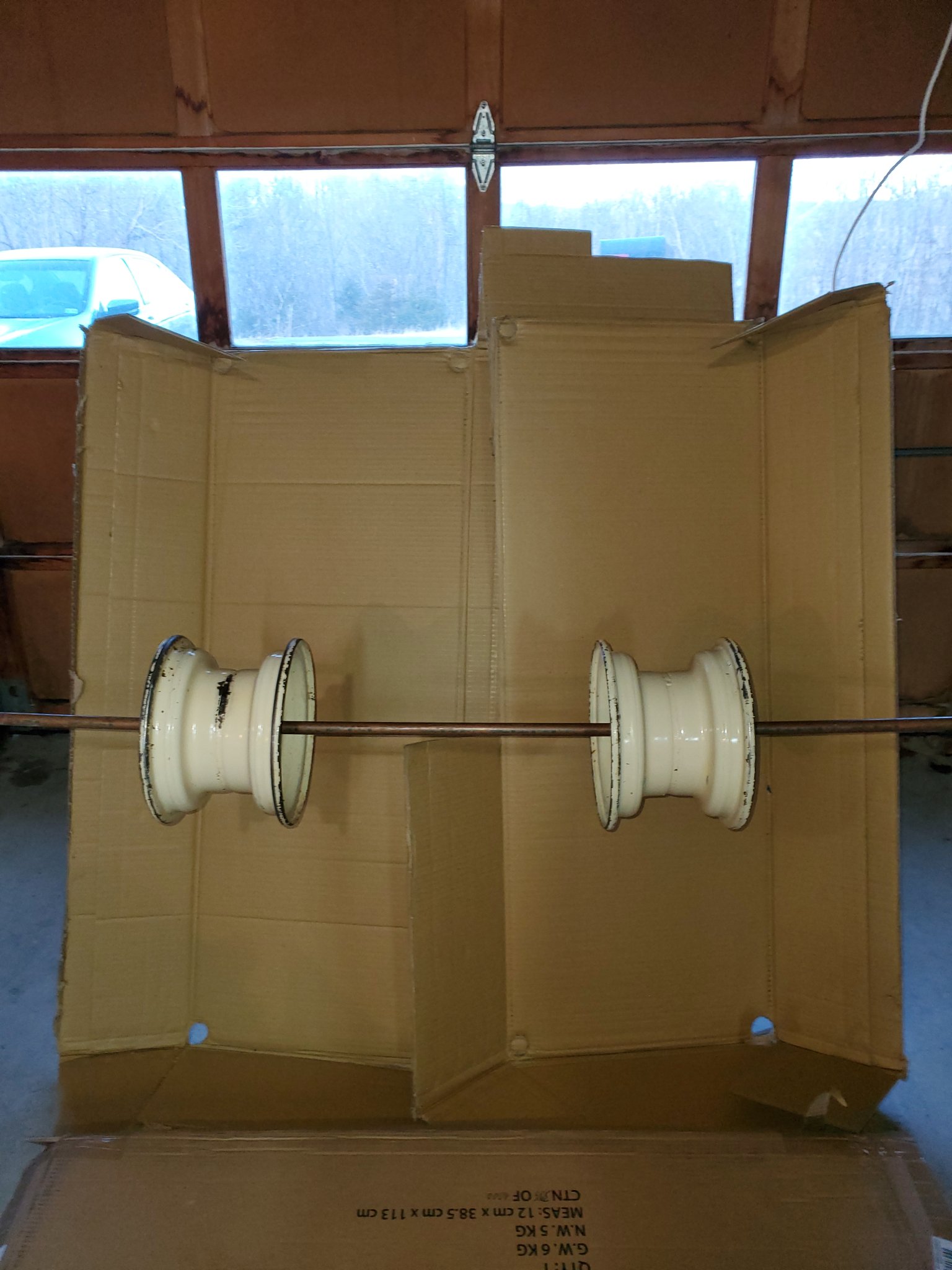

as far as I remember out of my head the G1800 front wheel rims are symmetrical and they have ball bearings both sides, 25mm inside diameter if I am not wrong.
Kind regards,
Hugo
p.s.: my left front wheel is leaking. Maybe we can swap one wheel, at least we have symmetrical front axles then again :ROFLMAO:
I had my tyre off already (what a job) and it is rim corrosion in my case. No point filling gunk in, corrosion removal and respraying has to be addressed at some stage and I don't want it to be messier than it is already. This is further down on my loooonnnng to do list :)

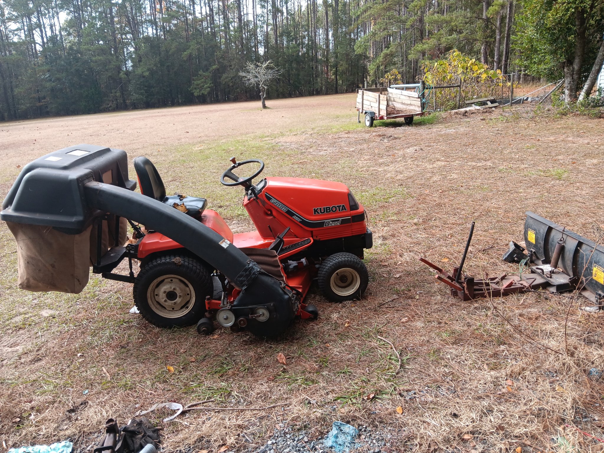

Is the grass catcher attached to the three point hitch? Was that always done like this?

I checked mine, and it's just dry rotted. The whole sidewall is leaking, so I ordered 2 new front tires (4-ply) and a set of tire spoons. I did get the rubber off the rim with flat screw drivers, but it was no fun! Rim is in good shape. I may go around the edge of the rim with a file and sand paper just to make sure there are no burrs before I install the new tire.

My, your rims look like an order of magnitude better than mine, mine are leaking at the rim... I also had a bit of fun getting the tyre off the rim despite having proper tyre levers. My tyre mounting machine does not handle 8" rims. But I think I will make adapters, I do not want to do that job by hand again.

Since the 3-point hitch is nearly impossible to find, has anyone put a sleeve hitch on a G1800? Something like this?
Anything is possible with a hammer and heat!

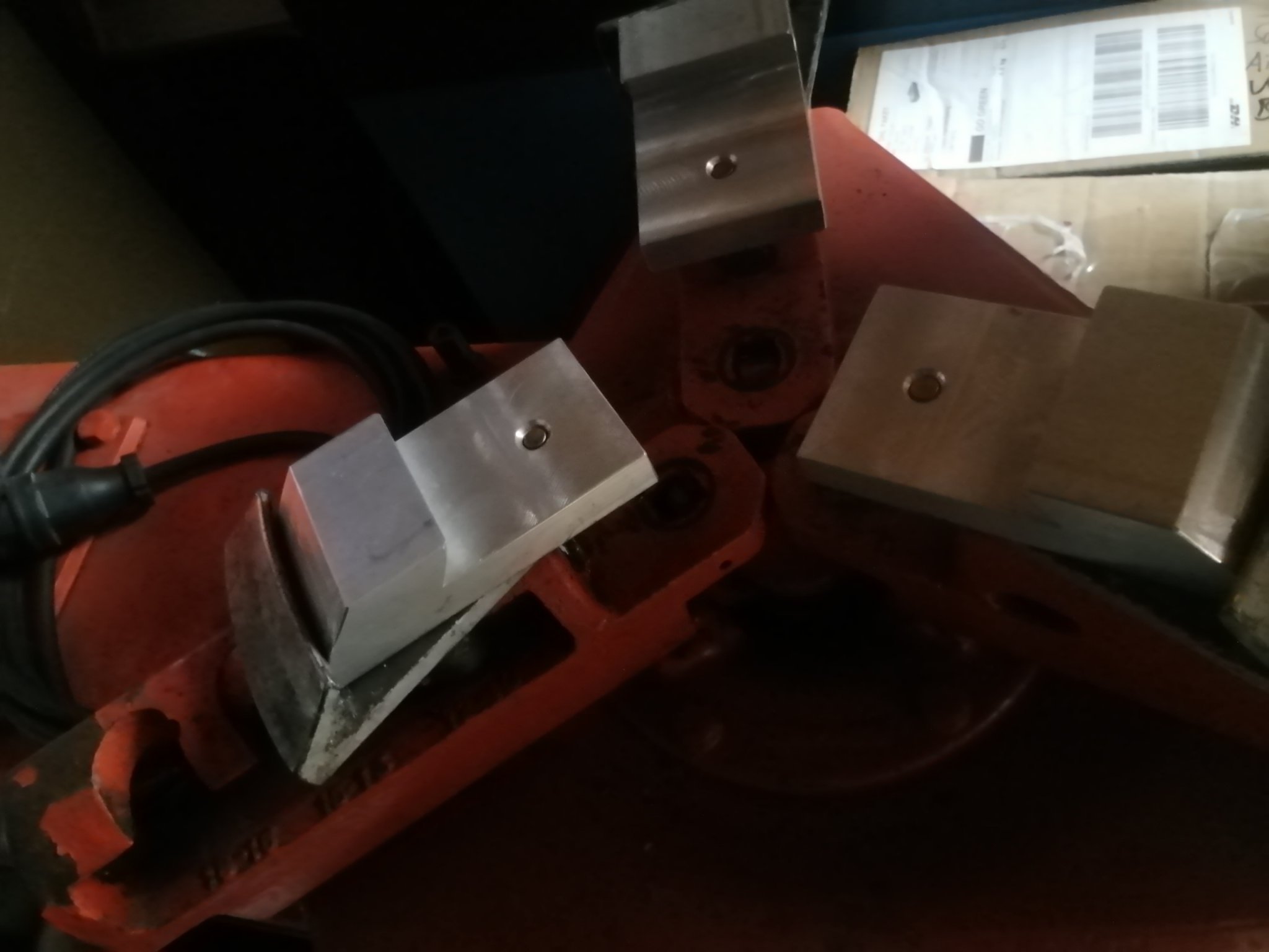

Made adapters for the tyre mounting machine, getting the tyre on and off is a doodle now compared to the endless struggle before with the tyre levers.

Wow! Nice tyre machine! Now it's time for a visit with Mister Wirewheel. The Rustoleum paint looks like an exact match, or close enough for a garden tractor. Is it available where you are?
