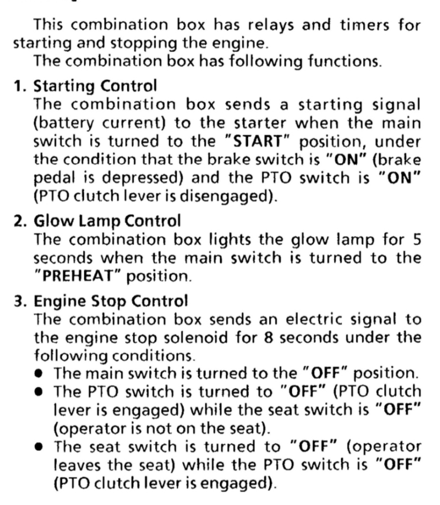

Hugo Habicht
G1900
Jun 24, 2024
244
303
Ireland
Congratulations to your new tractor! Fine machine in my humble opinion. :)
The parking brake has to be applied and the PTO lever has to be off, otherwise it will not start. Seat switch only applies when PTO is engaged, so engine will stop when PTO running and you get off the seat.
Are the hub caps in good condition? I find them rather cool and mine does not have any. Would you sell them by any chance?
This is from the manual:

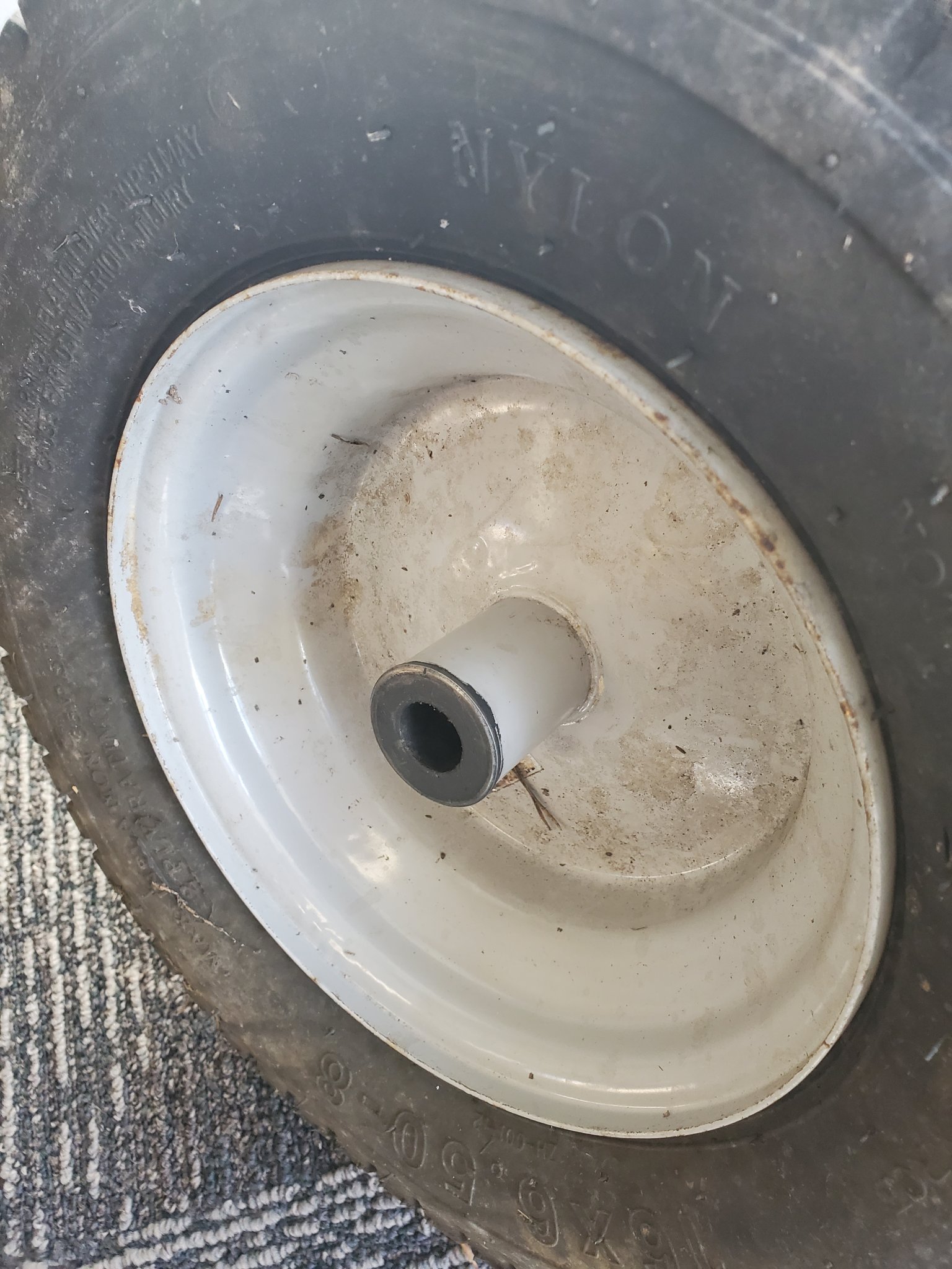

Chairwolf
Kubota G1800
Jan 19, 2025
17
Roanoke, VA
Question - the guy who sold me the machine told me that the right front tire leaked. No big deal. I was planning on putting some slime in it to see if that would take care of it. In the meantime, a co-worker of mine showed up with 2 brand new tires on rims that are the exact size that the G1800 takes. The question is, are the rims right?
Does anyone have a picture of the INSIDE-FACING side of the front rims? The pair that my co-worker has is made with kind of a "snout" on the inside, as the pics show. Will these work on the G1800?
Thanks
(Reason I ask, by the way, is because I'm not at home and can't see the wheels for myself!) :)
