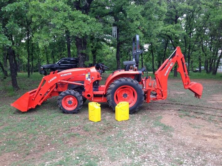

Greetings from Texas. New to the forum with my first tractor. I am not sure that I am posting in the right forum but I wanted to get some insight. I am on about 20 acres here in North Texas and plan to be using my tractor a lot. It is a L3301 and will be using the backhoe , box blade, and landscape rake. What are you guys using for fuel storage. I bought two of the NATO cans seen in yellow. Do any of you have the larger tanks where they deliver fuel ? Is it worth it ? Pros and Cons ? Thanks

I am also using some Jerry cans for fuel. I have two that I use for gasoline and one for diesel. One of the ones I use for gasoline is at least 55 years old, the other two I got off eBay at different times. I would like to get a transfer tank, but for now I will stick with the Jerry can. I hope you enjoy your L3301 as I have my L3901. I got it in Dec 2014 and already have 45 hours on it. Almost time for its first oil change.

Martin, those cans are great! When you get 'em up, the fuel really flows fast. At my age and condition, I find it necessary to pour off a couple of gallons into a small can, then heft that. A fuel station is in my dreams, but in reality, right now I use less than a gallon a month.
I suggest that you keep your eye out for a tank like Diydave recommends, and hold off on storage and contracting fuel delivery until you have a sense of your consumption. Contracting will save you a little, but you'll be locked in until the end of the year. And although you plan to use the tractor a lot (and I think the BH would be your biggest fuel eater), these machines seem to just sip fuel; I don't think you have enough information to determine the more economical way.

I'd also suggest you work through a few hard weekends using the cans and get a better idea what your fuel consumption will look like. I run mine off of a single 5 gallon can and have never run through that in a single weekend.

Original Poster says he'll be using the tractor a lot. There's a lot of variation in 'lot'.
Lifting those fuel cans will become less inviting after about the fourth time or so. And slopping diesel around the filler spout and over the hood and engine will make a mess that will accumulate oil-caked dust and reduce engine cooling. To fuel mine with a can I have to use a stepladder. Did I mention falling with a can of diesel landing on your chest?
Look on your local used market (garage sales, estate auctions, contractor auctions) or even Tractor Supply or Atwoods for new and find a steel tank and pump unit. CraigsList (caution for scammers) and maybe eBay are good if you shop carefully. Harbor Freight, Northern, your local cheap discount tool house.
I picked up another 55-gal white square steel tank couple months ago for a hundred bucks (garage sale, moving, everything goes) and had the electric dispensing pump included. A HUGE savings over new. I've seen 96-gal "L" toolbox tanks go by occasionally too. You just have to keep looking.
You can use the tractor to set the smaller 55-gal tank into your truck and run it to town to get fueled. Add stabilizer and you're good for six months or so.
Pull the tractor up to the tank (set on a pallet), clip the pump motor leads to the tractor battery, and pump away like you own a gas station.
A handy accessory is an automatic shut-off dispenser nozzle; again just like a gas station. Prevents overfilling and run-overs.
Don't forget to add a filter too: either a screw canister type (think oil filter) or a sediment bowl type. I use both and have a second canister attached right at the nozzle to keep hose deterioration debris out of the machine tank. Cheap insurance.
Before you fill your tank the first time, plumb a 1/4-in brass valve in the bottom side outlet so you can drain water off before every fill. Use a plug in the valve to prevent accidental opening the valve and spillage.
In your area there seem to be two brands of pump: GPI (silver) and FillRite (red). I've had commercial users tell me the GPI don't last.
If you don't want an electric pump to start off (building your setup in increments) you can use a steel tank with a manual hand pump. I'd go with rotary or diaphragm rated for diesel (although less common, you can find these used and worst case rebuild them). I've tried a $20 'water pump up- down handle' type barrel pump and found the packing at the rod port under the handle leaks no matter what I do.
Having a fuel dispensing station will make your life easier and save your back.
