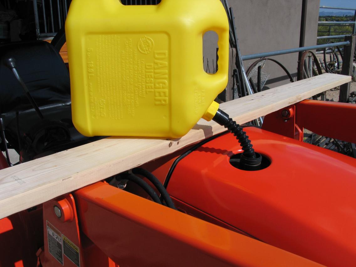

OK Guys... I put a lot of work into this.:D
The first pic shows the general idea. For the uninitiated to complex wood crafting, that is a 2x6. Once your fuel load is positioned on the beam, I use my finger to block the fuel spout until I rotate the fuel container and get the hose into the fuel tank and then I release. It's much easier on your back! And, you can get by with a board a lot shorter. Just sayin'!

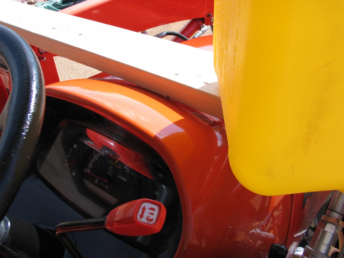

Picture two shows the conflict on the L3800 with the instrument binnacle. When I actually make the "for real" fuel bridge, I'll sand out the 2x6 and relieve that area for less conflict and contact with the binnacle. Also, if you added a 16"x16" 1/2" ply section on top of the bridge, it would give you more "shelf" to sit on. As you can see, the square fuel can hangs over quite a way but it is well balanced. Your results may vary.

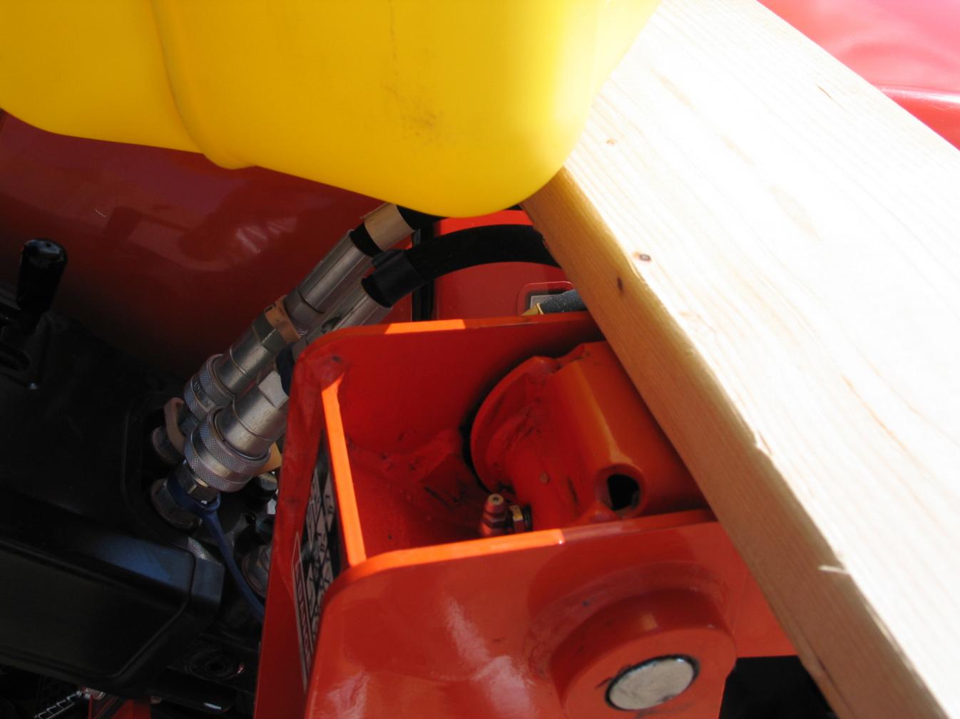

Picture three shows the FEL tower on the right side -I slid the bridge forward to see my tower detail. As you can see, this model has a pretty pronounced rectangular hole. Making a small block to fit inside this hole and attaching one on both end of the board would help lock the board in place while fueling.
Again, this idea may be adaptable to your machine. Sure helps me fuel and not strain my back for three jugs over five minutes.

Nice write-up, CCR, I expect I may be the only one who had trouble visualizing how you positioned the 'can' and poured the fuel.
