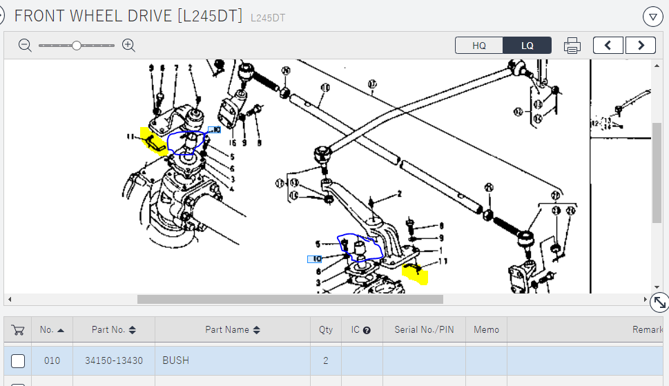

These bushings (Blue) are what controls that movement, not any of the bearings that you replaced.
Be mindful of the shims ( yellow) when you take it apart.

Does the “axle” wobble..? …or is it only the wheel/tire combo?

Wheel tire like it’s bad bearings but like I said I replaced all them it’s moving at the hub area where the tire mounts part number 20 on this first pic with the tire that’s why I’m confused I did bearings on both sides and other side is fine
