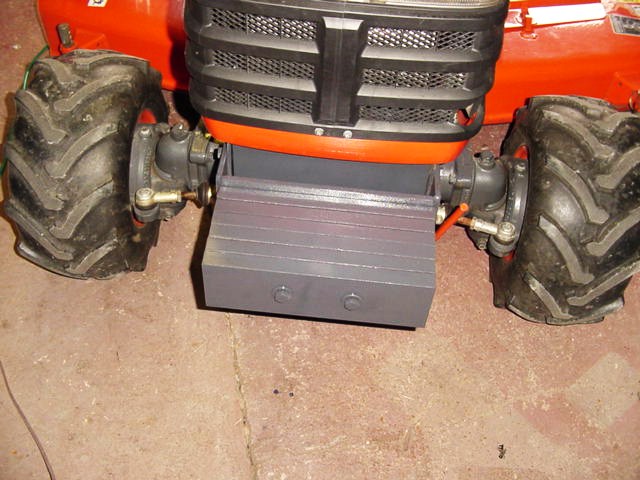

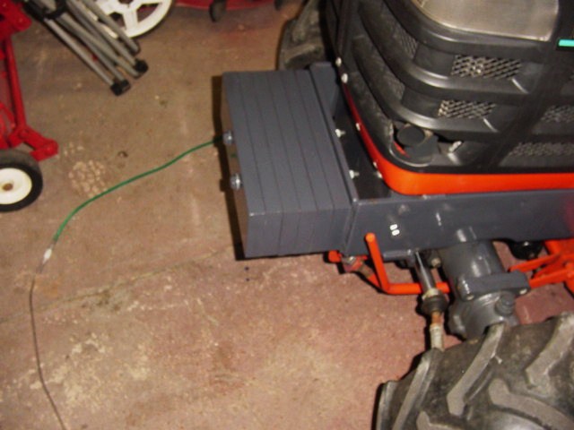

Have you thought of putting fluid in the front tires? It may not add very much weight but it will be where you need it and it's cheap.
I agree with Kytim though that suit case weights would be the best way to go. When I bought the ones for my 9000 I got the store brand instead of true Kubota weights. Not quite as pretty, a little harder to install, but they were under $80 each for 100# weights.

YEAH there's just something's you're better off going with OEM or a decent aftermarket on. And I agree with the other's. Proper suitcase weights would be the way to go here. Concrete is going to be a tough weight to judge to ballance out the front end. You'd have to start light and keep working up until you find the right amount of weight, then if you go overboard on weight you have to reduce it some how. Like with a BFH!
